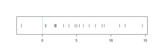

A stripchart shows that the mean $\bar Y = 5.2$ is not only larger than $0$ but perhaps convincingly larger in terms of the variability of the 20 differences.
stripchart(y, pch="|")
 abline(v=0, col="green2", lty="dotted")
A t test of $H_0: \mu_d = 0$ against $H_a: \mu_d \ne 0$ shows a P-value very nearly $0$ so that we reject $H_0$ in favor of $H_a$ at the 5% level of significance (and at some smaller levels of significance).
t.test(y)
    One Sample t-test
data: y t = 5.2565, df = 19, p-value = 4.497e-05 alternative hypothesis: true mean is not equal to 0 95 percent confidence interval: 3.134586 7.282414 sample estimates: mean of x 5.2085
In this one instance, a t test based on $n = 20$ observations from a normal population with $\mu$ one standard deviation $\sigma$ above $0$ seems to have plenty of power to detect that $\mu > 0.$
