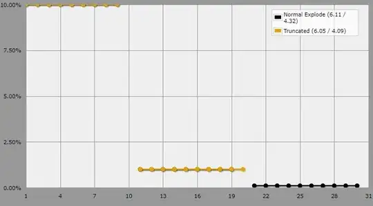

When working with many kinds of modeling there is a tradeoff between accuracy and speed. Anydice cuts us off on our speed, so we need to lose some accuracy. Anydice already truncates to exploding twice anyway and seeing as exploding twice on a d10 will only happen in 1 in a hundred throws the error should be fairly small.
For simplicity — rather than implementing a custom explode function — we can simply create the truncated exploded dice like this:1
D: {{1..9}:90, {11..20}:9}
Which I'd call close enough:
plot comparing exploded die with truncated
Anydice will then model up to 8k3, at least fairly close. It will slant slightly lower, and obviously loses out on the extreme highs (which are pretty much 0 anyway).

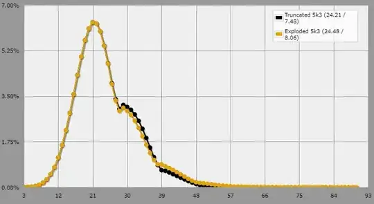

You can consider the effect for this for pools were anydice is willing to calculate with explodes, say for 5k3:
output [highest 3 of 5dD] named "Truncated 5k3"
output [highest 3 of 5d [explode d10]] named "Exploded 5k3"
plot comparing truncated and exploded for 5k3

    FYI, you can already change the explosion depth by set "explode depth" to 1, and defining a custom die rather than using the built in explosion function doesn't seem to be any more efficient in terms of how large a pool it allows you to consider. – Carcer Mar 20 '20 at 18:06
  • Taking this as a base, you get a much smaller margin of error by adding a 2nd. explosion and modeling it like this: https://anydice.com/program/1a8be - to cope with the larger rolls, you need to remove the last line. – Trish Mar 22 '20 at 15:27
  • @Trish: With the default explode depth of 2, [explode d10] is exactly equivalent to {{1..9}:900, {11..19}:90, {21..30}:9}. The only difference to your "truncated" die is that your last range ends at 29 instead of 30. (Effectively, you're conditioning on three consecutive 10s never happening, instead of counting it as 30.) While having 27 instead of 28 possible results for the custom die will surely have some effect on the runtime, It doesn't seem to make any practical difference. (In particular, it seems either way AnyDice can handle XkY for up to X=6 but not for X=7, regardless of Y.) – Ilmari Karonen Mar 23 '20 at 12:59

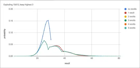

It looks like AnyDice just can't handle calculating "10k3" even with rerolls limited to just one. So I took my old dice probability calculator written in Python and added a few more features to it.
With the code from this GitHub gist saved as dice_roll.py in the current directory, you can load it into the Python REPL with python -i dice_roll.py and then e.g. calculate and print the distribution of 10k3 (with up to two rerolls by default) in CSV format like this:
exploded_d10 = explode(10, count=2)
for num, prob in sum_roll(exploded_d10, count=10, select=3, ascending=True): print('%d, %.12g' % (num, 100*prob))
Or just Try It Online!
The results, for various numbers of allowed rerolls per die, look like this:
Exploding 10d10 keep highest 3
Looking at the graph, one can see that the first two rerolls make a noticeable difference, but the effect of the later ones is pretty negligible. Which makes sense: for each die, the probability of getting at least n rerolls is 1/10n, so the expected number of dice out of 10 that get 3 or more rerolls is 10/103 = 1/100. And since this expected number of third rerolls is much less than one, it's also approximately equal to the probability of getting even a single third reroll. And the expect number of fourth rerolls, of course, is only 1/1000, and so on.
The Python implementation I wrote handles this problem better than AnyDice for two reasons. The first is simply that it doesn't have the 5 second runtime limit of AnyDice, so (at least when running it locally on your own computer) you can let it run as long as it needs to.
The second reason is that my code is actually a bit smarter than AnyDice, and avoids generating all the possible combinations of the lowest 10 − 3 = 7 dice rolls just to throw them away. This means that, despite Python being a much slower language in general than C++ (which I believe AnyDice is written in), my program actually manages to calculate e.g. 10k3 with max 2 rerolls in only about 0.1 seconds on TIO, significantly faster than AnyDice (which times out).
