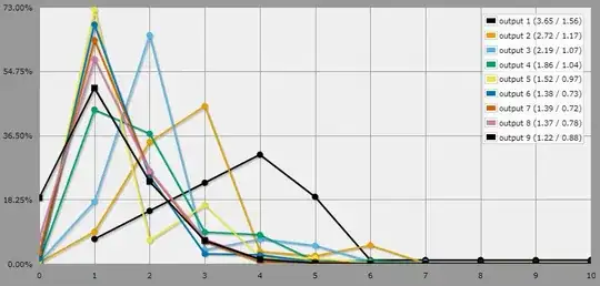

This is the result:
graph resulting from attemp
It doesn't look as I expected (I expected the first die to contribute more than the second, but further dice to start contributing more as they raise the chances of both a higher result and a higher count of it).
Which brings me to the question: was my expectation off-base, or does what I coded not do what I thought it would do?

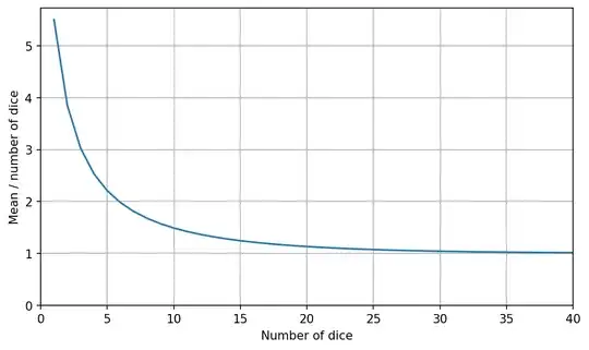

Results up to 40 dice
Normalized mean
This matches Ilmari Karonen's results.
I generated these results using my hdroller Python library. Computation time on my PC was under 0.2 seconds. The two key ideas for efficient yet flexible dice pool evaluation are:
  • Put the outer loop over the outcomes of the dice (e.g. 1-10 in this case). Don't iterate over the dice rolled.
  • Memoization.
In fact, Ilmari Karonen has mentioned both iterating over outcomes and memoization in the past, but I would venture to say that the full potential of these two ideas--especially combined--is greater than any of us imagined at first.

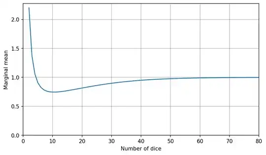

Marginal contribution to the mean sum
Here is each die's marginal contribution to the mean sum:
so Ilmari Karonen's conjecture about the behavior above 10 dice is exactly correct. For this plot, I doubled the maximum number of dice in order to emphasize the asymptotic behavior.
Note that the marginal contribution is not the same as the average contribution---taking the average dilutes the contribution of the marginal die across all previous dice.

I get a different result when I try to reproduce your described calculation using dyce¹:
from dyce import H, P
d10 = H(10)
def mechanic(nd10_roll): outcome_max = max(nd10_roll) # We are faithfully reproducing the approach here of (max * count). As alluded to # in the original question, we could have just as easily written something like: # max_sum = sum(outcome for outcome in nd10_roll if outcome == outcome_max) count_max = sum(1 for outcome in nd10_roll if outcome == outcome_max) max_sum = outcome_max * count_max # Rounding is optional. We do it here solely for display readability. return round(max_sum / len(nd10_roll), 2)
results = { n: P.foreach(mechanic, nd10_roll=n@P(d10)) for n in range(2, 7) }
... see graph/binder for visualization of results
I've attached the anydyce² graphs below. You can see my attempt (and play around with it) in your browser: Try dyce [source]
