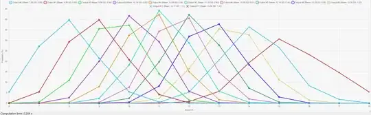

My Icepool Python library has a more efficient pool algorithm:
from icepool import Die
num_scores = 12 t = Die([2,3,3,4,5,6]) ability = 3 @ t pool = ability.pool(num_scores)
for i in range(num_scores): output(pool[i])
Result graph.
You can run this script online here.
