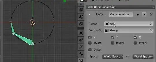

Next we add a copy location constraint of root bone to our mesh object, with base vertex group as a subtarget, and a track to constraint along the axis of bone "Y" to the next vertex group.
For all subsequent bones in chain add track to constraint to next vertex group.

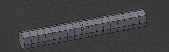

  • Create the armature, parent the object to the armature:

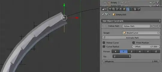

  • Give your empty a Follow Path constraint and choose the curve as the Target. The empty will stick to the beginning of the curve:
  • Duplicate the empty with a shiftDenter, change the Follow Path Offset of this second empty so that it is separated from the first with a distance of approximately one bone::
  • Create as many empties as you have bones, and again change the Offset of each one:
