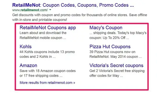

My website used to have sitelinks and now it doesn't. It's very possible that it's due to changing the website to a sidebar design instead of having an "interstitial" type landing page which limited the number of choices, but I'm not sure.
Here is how sitelinks might look for a site:
Google Sitelinks
What are some things that I can do to improve my chances of getting sitelinks?
