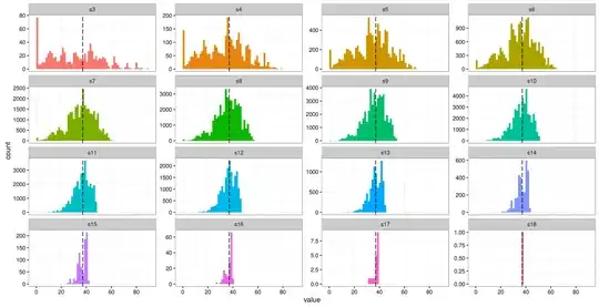

22
For what it's worth, I did a bit of a simulation study to look at the stability of the variance estimate for a relatively simple LMM (using the sleepstudy dataset available through lme4). The first way generates all possible subject combinations for ngroups number of subjects, and refits the model for each possible combination. The second takes several random subsets of subjects.

The dotted black line is the original point estimate of the variance, and the facets represent different numbers of subjects (s3 being groups of three subjects, s4 being four, etc.). enter image description here

It appears (for this example, anyway) that the variance doesn't really stabilize until there are at least 14 subjects, if not later.

    +1. Of course the smaller the number of subjects, the larger the variance of the variance estimator. But I don't think this is what matters here. The question is, what number of subjects allows to get some sensible results? If we define "non-sensible" result as obtaining zero variance, then in your simulation it happens quite often with n=5 or less. Starting from n=6 or n=7, you almost never get exact 0 estimate of variance, i.e. the model is converging to a non-degenerate solution. My conclusion would be that n=6 is borderline acceptable. – amoeba Mar 07 '18 at 13:39
    BTW this is in line with https://rpubs.com/bbolker/4187. – amoeba Mar 07 '18 at 13:46
