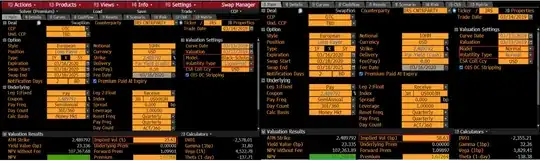

In the screenshot from SWPM below, Black and Bachelier are used to price the same option. NPV is practically identical, but Vol is different. However,
$$ 23.61 * 2.489792 = 58.78 \approx 58.63 $$

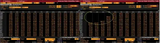

The purpose of a VOL cube is to combine liquid quotes of interest rate caps / floors and swaptions to a volatility cube that can be used to price interest rate derivatives. What quotes to choose is a bit of art. Essentially, liquidity is the main concern, and in terms of negative rates, also feasibility. For example, Black (lognormal) quotes are naturally undefined for negative rates as can be seen in the screenshot from VCUB below.

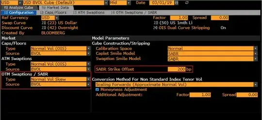

The ICAP page (VOLS) shows that there are also shifted Black quotes, but the market generally uses Normal Vols nowadays. Once the set of market data to use is defined, you need to combine the market data to a cube. in VCUB, you have quite a lot of flexibility here, where BVOL stands for Bloomberg Volatility, which is a combination of various market quotes on ALLQ, filtered for update frequency, spikes etc. If you want, you can directly choose a contributor of your choice as well (Tullett, ICAP etc.)
SABR is used to fit the vol surface to quotes. This will usually NOT fit quoted vols as it is a general best fit around all points. If matching quoted vols is a desired feature, you can for example combine piecewise linear within the quoted spectrum and SABR for extrapolation as a choice in VCUB.
The shift in the SABR model is to handle negative strikes and should not be confused with the shifted Black vol quotation. The Normal model is valid on (-Inf, +Inf) in strike dimension. However, the SABR model have a boundary at strike 0. That's why when you use SABR, you must set up a shift when you are dealing with negative forwards or strikes.
