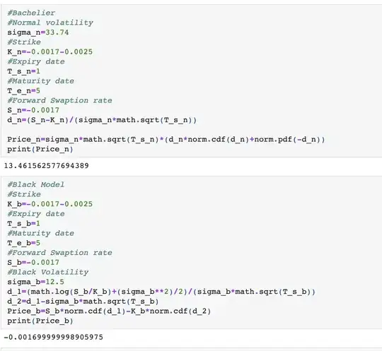

  • @KevinT thanks for suggestion so I looked on below thesis: https://research-api.cbs.dk/ws/portalfiles/portal/62188286/818135_Master_Thesis_125476.pdf and tested for 1y5Y swpation and firstly instead of getting shifted vol I tested with already given numbers but unfortunately not get satisfying results. Maybe you can look on my code and spot something wrong – Natan Kowalski Jul 20 '22 at 21:10
  • I added a code into original post – Natan Kowalski Jul 20 '22 at 21:16

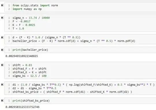

Since it would be too long for a comment and you made some effort at least in trying to replicate, I wrap this as an "answer" to your question, while leaving the last and actual part of extracting the implied vol rather than using the given data for you as an exercise.
So, I did not check all your $d$ and pricing formulae, but you can definitely recover the same option price using these implied vols. But you have to take care of the following:
  • work in decimals also for your vols - this is important, because normal vol is usually quoted in basis points, while lognormal convention is percentage points
  • your Black Scholes misses the shift! this is crucial for negative rates (as in your example)
Here is the "proof" that it should work: enter image description here
