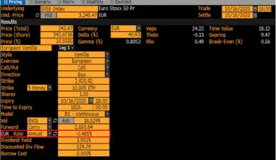

There is no problem with negative rates in the formula. Below is a screenshot from Bloomberg's OVME function where you can see that negative rates are indeed used in pricing as well. enter image description here

With options on spot (Black Scholes), you have the right to buy / sell spot at some future date. The right to buy means you do not forgo interest (as you still have that money at your disposal). If you have the right to sell (Long put), you could have sold it already, meaning you forgo the potential interest income. That is why the Greek $\rho$, which measures the sensitivity to the interest rate is typically positive for call options. It is also the reason why in the screenshot above, the call value gets smaller and smaller, the lower interest rates.
