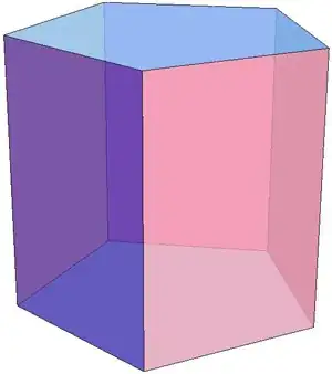

    A "cubical" die is of course not exactly cubical: the corners are rounded. How much rounding? One limiting case would be the intersection of 3 orthogonal cylinders, with corners shaped like small pieces of spheres. Now make the cylinders slightly squarish in cross-section, so the only stable configurations are on the faces. In this exaggerated form. Dice near the limit would seem to guarantee the phase space splitting as I described (with other orbits like rocking between corners). Another limiting case is an actual cube. The degree of rounding appears to make a difference. – Bill Thurston Dec 15 '10 at 14:38

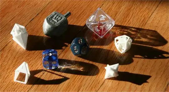

    This is not an ideal forum to mention this, but because of the interest raised by Bill's impressive reflections on the problem: (1) I purchased and control two 3D printers, and (2) I intend to print and experimentally investigate (with undergraduates) candidate fair but irregular polyhedra in the (U.S.) spring 2011 semester. Any and all ideas/advice would be greatly appreciated! Thanks! orourke@cs.smith.edu – Joseph O'Rourke Dec 15 '10 at 22:43
  • @Joseph: What a nice idea! I bet the undergraduates will have some good ideas. Will they have software good for designing the shapes? How bouncy are the materials you can use for your 3D printers? – Bill Thurston Dec 16 '10 at 03:48
    @Bill: One printer prints ABS (hard) plastic, which should suffice. We'll work in Mathematica and export in a format the printer can accept. – Joseph O'Rourke Dec 16 '10 at 12:02
  • @JosephO'Rourke Were you able to carry out the planned study in 2011? Do you have a report, or any results? – Zach Teitler Apr 26 '18 at 21:10
    @ZachTeitler: We did print various height pentagonal cylinders and collected statistics on rolls, but we never surmounted the problem of randomizing the die throws uniformly. So: No written report. But I still have the cylindrical dies. :-) – Joseph O'Rourke Apr 26 '18 at 23:34

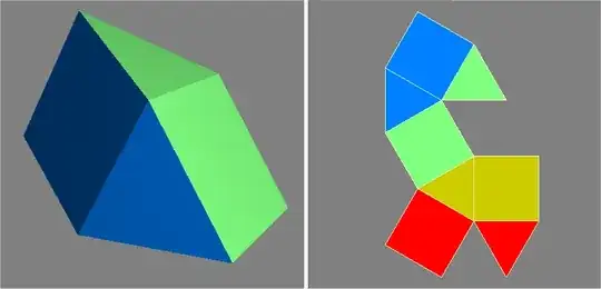

Let me use this non-answer to display an image of a heptahedron that follows the Diaconis-Keller/sleepless construction, but in which I adjusted the dimensions to satisfy Benoît Kloeckner's idea of equal solid angles, in this case about 1.795 steradians per face, which is $4 \pi / 7$:
          Heptahedron
