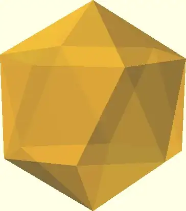

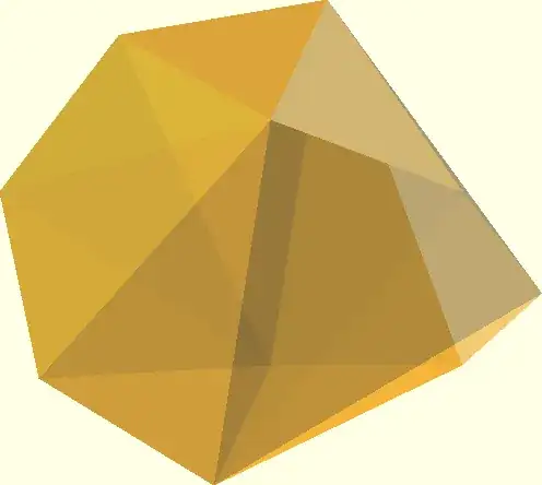

As M. Winter pointed out there is a family of polyhedra with $4k$-faces which fit the bill ($k=5$ is the icosahedra). Here is an image for the case $k=4$ and $k=6$.
Start with an antiprism over a $k$-gon (say the lower $k$-gon has vertices with coordinate $(e^{i \pi (2j+1)k},0)$ and the upper vertices $(e^{i \pi 2j k},h)$ where $0 \leq j <k$ and $h$ is a real number; I'm using complex numbers for the $x$ and $y$ coordinates). Glue a pyramid on each $k$-gon (the tip of the pyramids are at $(0,0,s)$ and $(0,0,h -s)$. The centre $C$ is at $(0,0,\tfrac{h}{2})$.
For the triangles to be congruent one can write $h$ as a function of $s$ (it's $h = \tfrac{ 2\cos(\pi/k)-1+s^2}{2s}$). If $k>3$, requiring each face to be at the same distance from $C$ (i.e. $C$ will be the centre of an insphere) will fix a value of $s$ (it's $=\sqrt{2\cos(\pi/k)+1}$). The point of the faces which minimises the distance to $C$ are [rather, seem to be] the circumcenter of the triangles (only checked this for $k=4,6$ and $7$ [I was too lazy to do the algebra for general $k$]).
From there it follows that these solids are pseudo-Catalan (they cannot be Catalan [if $k \neq 5$] since the vertices at the tip of the pyramids have degree $k$ while the other vertices have degree 5. Hence there is no global symmetry which sends a face from the pyramids to the antiprism.
I would tend to believe that these solids are in a larger family with scalene triangles. A similar construct based on trapezohedra (instead of dipyramids) would be fun (but I have no idea how to do this at the moment).
EDIT: the case $k=3$ is singular: if you force the planes of the faces to touch the insphere, you get a trapezohedron (whose faces are rhombi; i.e. the triangles of the pyramid align perfectly with those of the antiprism). If you further use the remaining parameter so that the closest point to $C$ is the same on each [triangular] face, it actually gives the cube (!).

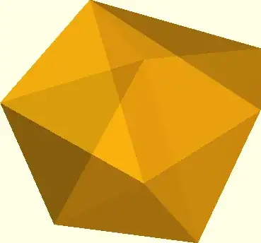

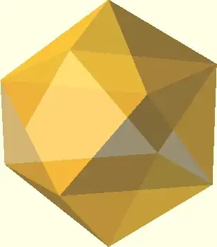

Here is another (and hopefully simpler) example (though definitively not a complete list of possible solids). Take a $k$-dipyramid (the equatorial vertices have $xy$-coordinate which are $k^\text{th}$-roots of unity and $z=0$). Let the tips of the pyramids be at $(0,0,\pm 1)$. When $k$ is even (so $k \geq 4$), one can cut this pyramid along the plane which goes through the tips and the roots of unity $\pm 1$. This cuts the dipyramid along a square. Now rotate one of the two pieces by 90° and paste them back together. The resulting solids (which should, I assume, be called gyrate dipyramids) satisfy the required conditions.
To see that these are not Catalan solids (unless $k=4$, which is just taking the octaeder, cutting it and putting it back together) just observe that there are two types of faces: those which touch the square where the glueing occurred and the others.
Here are some pictures for $k=6$ and $k=8$.
