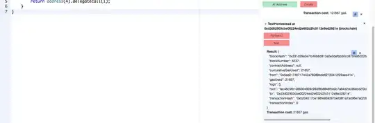

7. Testing For The Homestead Mode
I loaded the test script by @TjadenHess from How could I update default homesteadBlock value on my private Ethereum blockchain? into Solidity Browser:
contract TestHomestead{
    function test () returns(bool){
        return address(4).delegatecall(1);
I connected Solidity Browser to my local private node by clicking on the block icon and selecting Web3 Provider. I then clicked on Create to deploy the contract above to the blockchain. I clicked test and the message Transaction cost: 21657 gas. shows that my blockchain is in Homestead mode.

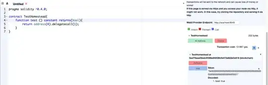

Note: If I alter the function to make it a constant function test () constant returns(bool){, I get the following results for a Homestead mode blockchain - true:
See section 9. below for the message displayed when the blockchain is in non-Homestead mode.

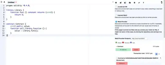

I've modified the library call source code slightly to make the value variable public, and loaded this into Browser Solidity :
library Library {
    function func () constant returns (uint8) {
        return 5;
contract Contract {
    uint8 public value;
    function call_library_function () {
        value = Library.func();
I clicked Create to deploy the code, call_library_function to execute the method, and value to view the library call function result:
Success
The message Transaction cost: 41914 gas. and the value of value shows that the library function call succeeded.
