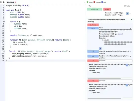

Summary
  • Replace from:accounts[0] with from: web3.eth.accounts[0] (or from: eth.accounts[0]), add a , before function and your code should work.
Quick Code Check
Your code works perfectly in Browser Solidity:
