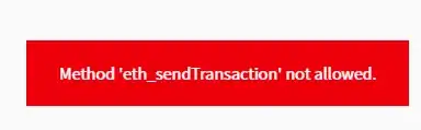

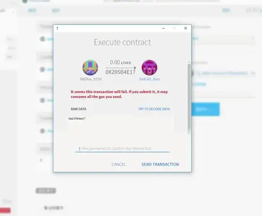

I am a new comer to the Ethereum and I am writing a piece of smart contract for my project. I used Win 10 and Mist 0.8.8 with the testnet that started with "R".
The contract code has the functions of changing the state and some modifier, however, after I launched the contract, I am not able to run any functions of it. The following errors show up. Thank you so much!!!
The contract code is show below: Thank you so much!

From the raw data 0x295b4e17 in your first image, you are trying to execute the paid() function.
I checked each of the function signatures in the geth command line and the following signature matched:
> web3.sha3("paid()").substring(0, 10)
"0x295b4e17"
This paid() function has the modifier inState(State.Received) and this modifier will throw an error is the current state variable is NOT State.Received.
The warning you are being show is because Mist simulates the call you are attempting to execute and has determined that the call the paid() will fail as the current state variable is not set to State.Received.
To test out your functionality, you could either:
  1. Add other function(s) to move your workflow state to State.Received; or
  2. Remove the inState(State.Received) modifier from the paid() function.
I would suggest firstly trying 2. above so you can determine whether you can execute the paid() function successfully. Once you have confirmed that the paid() function without the modifier executes successfully, create the other require functions to move your contract state to State.Received when paid() with your modifier will work.
