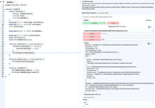

Deployment And Execution In Browser Solidity
Here is a screen showing the deployment ("Create") of the contract and the execution of setTrue(...) using 43,324 gas and the event result true: enter image description here
Here is a screen showing the execution of getValue(...) using 22,901 gas and the second event result true: enter image description here
Here is a screen showing the execution of setAddr() using 27,867 gas and the third event result true: enter image description here
