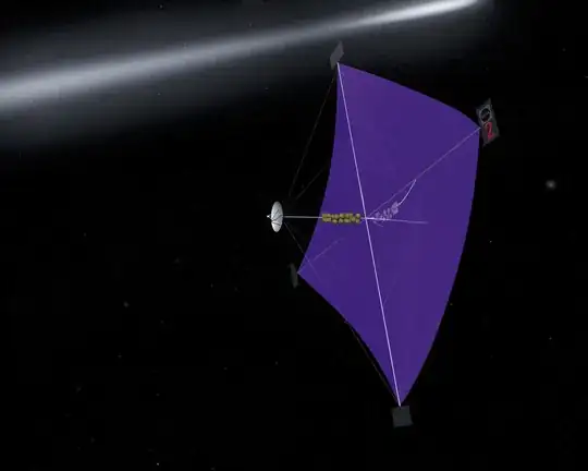

Use a solar sail.
Advantages:
  • Solar sails are lightweight(-ish)
  • They can be used for propulsion
  • According to Dandouros et al., solar sails built with technology in the near future could easily travel to a nearby star system in 60 years, reaching a top speed of $0.16 c$.
  • You might want to use a solar sail merely for braking, so it's good that solar sails are low-mass (see this article, especially the part about the material called CP-1) and can be folded up.
For the calculations, an interesting reference is Solar sail thrust calculation:
In Space Mission Engineering: The new SMAD, page 555, section 18.7.2, the following thrust formula is given for a solar sail: $$F=\frac{2RSA}{c}\sin^2\theta=9.113\times10^{-6}\frac{RA}{D^2}\sin^2\theta$$ Where, $F$ is the thrust; $R$ is the fraction of incident light; $D$ is the distance from the Sun in astronomical units; $S$ the solar flux in $W/m^2$; $c$ the speed of light; $A$ the sail area in $m^2$ and $\theta$ the sail tilt angle.
If we set $\theta=\frac{\pi}{2}\text{ radians}$, then we find $$F=9.113\times10^{-6}\frac{RA}{D^2}\tag{1}$$ If we're being optimistic, and saying that $R\approx 0.5$, then $$W(s)=\int_{s_0}^s F\cdot dD=\int_{s_0}^s 9.113\times10^{-6}\frac{A}{2D^2}dD$$ $$W(s)=-\left[9.113\times10^{-6}\frac{A}{2D}\right]_{s_0}^s$$ Here, $W$ is work. Be careful to also account for changes in potential energy in your calculations. Also, there should actually be a sign flip in there (i.e. the $-$ should by a $+$), but that's superficial.
We can then use $$KE=\frac{1}{2}mv^2$$ to find the speed at any given distance, assuming that $S$ is constant (which it isn't - it's a function of $D$); given that $\frac{dS}{dD}\neq 0$, that must be accounted for for long-distance calculations.
For more fun, use $v=\frac{dD}{dt}$ to find the time it will take the sail to go from one point to another.
Since solar sails don't use fuel, there won't be any pollution or fallout from their use. They're a perfectly clean propulsion and braking technique. Also, you say you're using laser propulsion. Perhaps you could create (hypothetically) a large group of lasers and fire them at the craft, creating additional thrust.

    Great, except . . . every 4-microgram interstellar dust speck will impact your flimsy sail with kinetic energy equivalent to 14.3 kg of TNT at 0.6c relative. Yes. Every dust speck will do the damage of three anti-tank mines.
    Sorry.
    – geometrian Aug 31 '15 at 14:00
    @imallett Wouldn't that be a problem for pretty much any ship? – HDE 226868 Aug 31 '15 at 14:02
    Absolutely. But most ships have it easier since the way they try to slow down isn't using a mylar bag turned broadside to relativistic bombardment. – geometrian Aug 31 '15 at 14:10
    @imallett makes me think of a kind of interstellar parachute.... could you use a thicker, ablative material and a large change in surface area to slow down? – codeMonkey Aug 31 '15 at 16:20
  • @codemonkey if you had a thicker sheet and the dust specks could be relied upon to impact your shield you could even reduce the size of the sail due to the plasma bursts granting additional backwards momentum. Sadly that's somewhat similar to saying that a soldier could gain additional momentum from hollow point rounds being fired at his parachute if it was thick enough. – Joe Bloggs Sep 02 '15 at 12:49
  • @JoeBloggs think of areo-breaking with the Apollo missions: the areo-break (heat shield) absorbed a bunch of energy, and then they deployed the parachute. Similarly, here I would deploy a "dusk-break" to reduce speed through friction with the interstellar medium, followed by a light-sail to slow to orbital speed. the more I think about this, the more reasonable it sounds... (for values of reasonable that include interstellar transit) – codeMonkey Sep 02 '15 at 13:59
  • @codemonkey Could work, though the important thing about the interstellar dust is that it's a fairly constant medium. The ship is going to be experiencing that kind of energetic impact through the entire journey without the 'discrete' change into atmosphere, so you'd have to fold up the dusk-break into the ship while also making sure it's got enough material to ablate and enough surface area to slow the vessel down when unfolded.. would be one funky looking ship! – Joe Bloggs Sep 02 '15 at 14:11
  • Unfortunately, solar sails aren't light-weight beacause they can be, but because they have to be. To change the momentum of a ship massive enough to hold troops, shuttles etc. using solar winds you'd need sails of dyson-sphere magnitude, which is not very practical. – Annonymus Jul 30 '16 at 12:58
  • @imallett Wouldn't the dust just punch through the sail, leaving a very small hole? I think a solar sail with a tiny hole in it is still a solar sail. And interstellar dust is supposed to be relatively rare. – Profane tmesis Jan 17 '17 at 22:32
    @Peter Roughly speaking, momentum is what causes penetration, kinetic energy is what causes damage. There's not great data about hypervelocity impacts, certainly none about relativistic impacts, but the general expectation is that (since momentum is linear and KE is quadratic) hypervelocity impacts look less like penetrators and more like point-source explosions.¶ If you somehow survive the dust specks, maybe try the proton flux? At 0.6c, it's about 42.25 petaelectronvolts per square centimeter per second. – geometrian Jan 19 '17 at 01:09
  • Braking with a solar sail can only work if you have a laser battery at the destination similar to the one you used for launching. Braking on the primary star will not work due to material constraints, see my answer below. – Anton Tykhyy Oct 02 '17 at 06:58
There are no good passive braking methods for such speeds that don't smash the mission. The key factor is that maximum mission deceleration is limited to fairly low values, which means a large braking distance.
Solar sails. Using the notation of HDE-226868's answer, the braking force is $F\simeq10^{-5}\frac{N\cdot a.u.^2}{m^2}A/D^2$. It is obvious that mission deceleration will be greatest at the minimum distance: $Mg_{max}\simeq10^{-5}\frac{N\cdot a.u.^2}{m^2}A/D_{min}^2$, where $M$ is the mission mass and $V$ will be the mission velocity. The work of the braking force, braking from infinity, will equal the mission's kinetic energy at infinity:$MV^2\simeq10^{-5}\frac{N\cdot a.u.^2}{m^2}A/D_{min}$ (the term corresponding to maximum distance vanishes). Dividing these two equations, we can obtain the relation $g_{max}D_{min}\simeq V^2$. It holds for any solar sail regardless of efficiency, material, target star &c. For interstellar but not relativistic speeds, let $V=\beta c$, then $D_{min}\simeq\beta^2\frac{c^2}{g}\frac{g}{g_{max}}\simeq10^5\,a.u.\beta^2\frac{g}{g_{max}}$ where $g$ is Earth gravity. Substituting this back into the mission deceleration equation, we see that the area density of the sail is inversely proportional to the fourth power of mission velocity: $M/A\simeq10^{-16}\,kg\,m^{-2}\frac{g_{max}}{g}\beta^{-4}$. If the mission is carrying something squishy like humans, $g_{max}$ must be on the order of $g$. Assuming a mission velocity marginally attainable with known technology $\beta=0.1$, our braking sail must weigh at most $10^{-12}\,kg\,m^{-2}$. This is quite beyond the capacity of any known reflective material. (For comparison, a one-atom-thick sheet of aluminium would be around $10^{-7}\,kg\,m^{-2}$.) A fully solid-state probe could, perhaps, sustain decelerations as high as $1000g$, but the sail would need to sustain them as well. Solar sails aren't likely to be useful for braking an interstellar mission.
Braking on interplanetary medium. Unless one is traveling to a young planetary system full of dust (which, ipso facto, will have no useful planets), IPM seems to be only dense enough to be a nuisance and many orders of magnitude away from being useful for braking a mission traveling at interstellar velocity. If we assume that IPM material simply accretes to the mission, the braking force $Mg_{max}=\rho SV^2$ where $\rho$ is IPM density and $S$ is the cross-section of the mission vehicle. Mean IPM density in the vicinity of Earth is on the order of $10^{-19}\,kg\,m^{-3}$[1], and it falls off with distance from the primary as $r^{-1.3}$[2]. For given $V$ and $g_{max}$, mission vehicle must have $M/S\lesssim\rho V^2/g_{max}$. The latter fraction is just the braking distance: $D_{brake}\sim V^2/g_{max}$, so $M/S\lesssim\rho D_{brake}$. Using again $g_{max}=g$ and $\beta=0.1$, $D_{brake}\sim10^{14}m$ and $M/S\lesssim10^{-6}\,kg\,m^{-2}$. This is much less flimsy than the solar sail, above, needs to be. However, the braking distance ($600\,a.u.$ in our case) is much larger than the effective radius within which IPM is sufficiently dense.
If hypervelocity impacts of IPM particles produce explosions and eject material, the braking force seems to be enhanced by a factor of $\sim\frac{v_e}{L}V$, where $v_e$ is the exhaust velocity of ejected material and $L$ is the specific heat of sublimation of the materials involved. For $\beta=0.1$ and $v_e\sim 3\,km\,s^{-1}$ characteristic of chemical explosions, this factor is on the order $10^2$ and the mission can be heavier, $M/S\lesssim10^{-4}\,kg\,m^{-2}$ (though it must now withstand the explosions, a daunting prospect). Nevertheless, this does not remove the tyranny of braking distance and probably precludes the use of this braking method.
Electrodynamic braking on interplanetary magnetic field does not appear to be effective [3].
