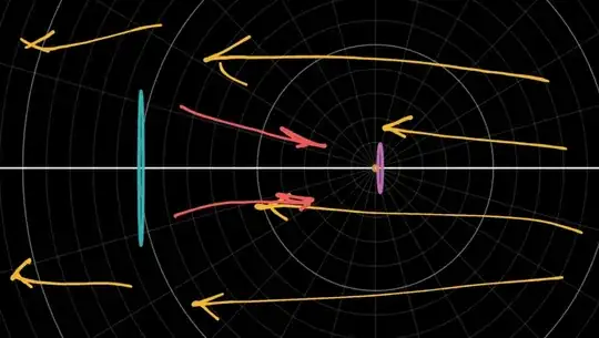

Use the laser highway system to both accelerate and decelerate your spacecraft
lightsail config
The yellow arrows represent the laser light coming from the origin star system (the one with the laser infrastructure). The red arrows represent the laser light bounced back off the blue detached light sail, onto the pink light sail attached aft of your spacecraft.
The pink sail receives light from both behind and in front, however, the blue sail is focusing more light down onto the pink sail's front, so the net effect is deceleration.
The blue sail, after detaching, will continue accelerating out into space. No way you're getting that back.

  • I was considering something like that, but can these beams really be effective at interstellar distances? Is it really possible to create a laser that can retain such high levels of concentration over such vast reaches of space and time? I was imagining the ship being in-system while being pushed up to speed over the course of a few months to a year, and those distances are manageable for the beam tech they have in this setting, but interstellar distances are mindbogglingly vast, and make solar systems look microscopic. I don't buy it, but then again, I know hardly anything about lasers. – EldritchEntity Jul 05 '21 at 21:40
    @EldritchEntity for interstellar travel, the laser would need to be tremendously powerful and the sail tremendously enormous. If you have the power and focus the light properly, it can be done. Using Robert L. Forward's lightsail from his novel Roche World... A 1,500 Terawatt laser at Sol shone through an "acceleration lens" 100 km in diameter. In the acceleration phase the laser propelled the spacecraft, rigged on a 1000 km diameter aluminum sail, at 0.01g for 20 years, sending it 2 ly distant at 0.2c. (cont.) – BMF Jul 05 '21 at 23:19
    A 300 km deceleration lens was swapped out and the 1000 km sail was ejected to focus the laser light down onto a 300 km sail, decelerating for 20 more years and covering 4 more ly. I may not have all the information I need to backup Forward's numbers, but he writes mostly hard-scifi and I trust his conclusion that his lightsail system works. I imagine it could be scaled up quite a bit to higher accelerations and shorter transit times, potentially looking at lenses and sails tens of thousands of km in diameter. But that's miniscule when your people build Dyson swarms. – BMF Jul 05 '21 at 23:22
  • I've seen this many times, but the ring sail is simply propellant. The specific velocity is limited by how well the beam can be focused. It seems like it would be more efficient to capture the light energy and use it to work an ion drive. – Mike Serfas Jul 06 '21 at 00:47
  • @MikeSerfas Yeah, that makes sense. The beam can bounce back between the two sails multiple times, but in the end, what you're essentially doing is pushing off the big lightsail. Ion engines are about the most efficient way to push off of stuff. – BMF Jul 06 '21 at 00:55
  • @BMF Ion engines don't have anything like the ISP to brake down from relativistic velocity. Laser-pumped lightsail is about as good as it gets. If you have big enough lasers on both ends and a shiny enough sail it outperforms even antimatter. – Loren Pechtel Jul 06 '21 at 01:16
