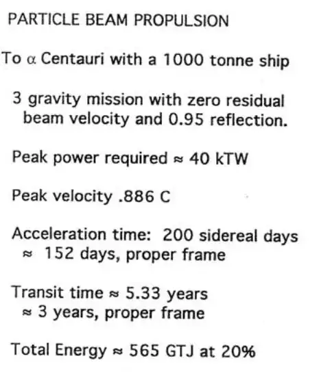

Gerry David Nordley is a major proponent of particle beam propulsion. Taking his proposal to send a probe to Alpha Centauri at a large fraction of lightspeed (0.8667 c) with an acceleration of 3 g over 122 sidereal days.
If a particle beam system is used to decelerate the runaway ship. let's use a PB system with exactly the same characteristics as Nordley's Alpha Centauri probe. It has to decelerate a ship from 27.000 km/s to relative rest with respect to Alpha Centauri.
The probe has 86.67/9 squared times the kinetic energy of the Centauri Pilgrim or 92.74 times if its velocity was pure Newtonian. At 0.8667 c, it has Lorentz factor of two. So multiply the value for kinetic energy by, say, nine. This gives an approximate relativistic kinetic energy of 834.6321 for the probe. Since the Nordley PB system accelerates the probe at an acceleration of 3 g, then we can multiply by another 3 to account for an acceleration of 1 g to decelerate the Centauri Pilgrim.
If a PB system is deployed in the Alpha Centauri to decelerate a runaway ship moving at 27,000 km/s, and with the same characteristics as Nordley Alpha Centauri probe, then it will be capable of decelerating a vessel with a mass of 2,503,896.3 tons at 1 g in a period of 31.89 days.
An interstellar vessel with a mass of 2.5 million tons can more than readily accommodate 100,000+ colonists. Using the known parameters of particle beam propulsion system and then calculating what mass vehicle it could decelerate confirms this system would be more than adequate to safely bringing a runaway colony ship to stop at its destination. The vessel turns out to have more than enough capacity to accommodate the OP's proposed complement of colonists.
