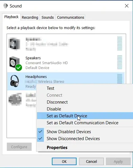

  2. Mark it as your default device in “Control Panel” → “Hardware and Sound” → “Change system sounds” → “Playback”.  (It may be good enough to go to “Control Panel” → “Hardware and Sound” → “Sound”.)  Select your Bluetooth device and select set defaults.
    Default Audio Device

43
I just ran into this issue, turns out I had two profiles, Hands Free and Stereo, I was using hands free, changed to stereo and this fixed the issue:
Hands free vs Stereo

    Thanks! I totally missed this, I have the same choice. This is a much better solution, because it allows you to use either telephony OR high quality audio as the situation allows - rather than completely disabling that functionality at a system/driver level as others have suggested. – darkbluesun Oct 15 '16 at 09:07
  • I had the same thing, until one day, the stereo profile disappeared. Had to use the option where you disable handsfree telephony from the hardware & sound -> printer & devices -> [select device] -> Services - for this to even be visible again. – Kalec Mar 18 '19 at 12:19
  • Wow, setting "stereo" as default device instantly quadrupled the sound quality in the song I was listening! – Jeremy Thille Apr 13 '21 at 07:58
  • This solution still works in windows 10. – julaine Feb 26 '24 at 16:49

Just a note for iTunes users, you need to make sure you right click the bluetooth profile/device and "Set as Default Device" which will route all of your computer's audio to the bluetooth speaker/headset.

even ifs marked as your default you need to click on headset as default then click your bluetooth device as default again. For whatever reason it fixed my issue. So even if it is set as default change it then change it back. Worked for me.
