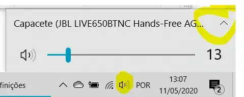

I bought some JBL LIVE 650BTNC headphones and am trying to use them via bluetooth on a windows 8.1 laptop. The pairing works, but the sound quality is abysmal. This is not the case if connected via cable, or paired via bluetooth with my phone.
I read that the problem might be that the combination of mic + speakers are a bit too much for a bluetooth connection to handle without reducing sound quality. You can therefore find a multitude of recommendations to disable the "handsfree telephony" option in the device option or even just pick a different "non-hands-free" playback device - see here for an example for both solutions from superuser.
However, those don't work for me: in my playback device list, the headphones only get a single entry. And if I uncheck the "handsfree telephony" option (or deactivate the driver of the headset microphone in the device manager) the headphones just stop pairing with the laptop altogether and won't reconnect (until I re-check the option/enable the driver again).
It seems, for this model, the option for disabling handsfree talk is just not there? Am I therefore stuck with this bad audio quality when using bluetooth via my laptop?
