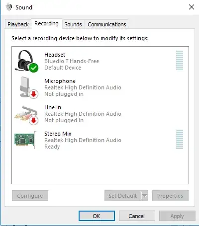

I have headphones that have 2 audio inputs, and 1 mic audio output:
They're made by a Chinese company called Bludio.
By default, the headphones are configured as in the above screen shots.
However, when the microphone is used / picks up noise, the STEREO output is muted. I have no idea why, or whether it's a windows/software issue, or something the manufacturer configured in their firmware.
I can combat this by setting the HANDS-FREE as both the communications and Default device (so the stereo is no longer used, and only the hands-free output has a tick).

EDIT: The guys in this post seem to be having the same problem. Like me, they had to either disable the mic so the STEREO output stopped getting muted, or use the bad quality HADNS-FREE output.
However they went into the bluetooth settings on the headphone, and disabled "hands-free telephony" altogether. All this does is completely disable the hands-free portion of the headphone, so the mic can't be used.

    @leonheess I believe this is a bluetooth issue; the device can't handle sending microphone audio while receiving high quality audio, so it lowers the input audio quality. Essentially, the bluetooth bandwidth is too low to support normal audio while also sending mic audio. – Tobi May 10 '20 at 05:48

@leonheess I believe this is a bluetooth issue; the device can't handle sending microphone audio while receiving high quality audio, so it lowers the input audio quality. Essentially, the bluetooth bandwidth is too low to support normal audio while also sending mic audio. – TOBI
This is exactly what I found to be the issue. Bluetooth 5.0 has double the bandwidth so if you don't have a 5.0 adapter that may be possible solution.

If you are using a BT headset with Windows when you start using the mic the headset changes from the A2DP audio profile to the HFP audio profile. HFP only supports mono output.

You may want to check at control panel-->devices--> on the BT headset go to properties--> services, check if any option is unticked; this did the trick for me with an older model of bluetooth where it had an handfree or something unticked.
Hope this helps.
