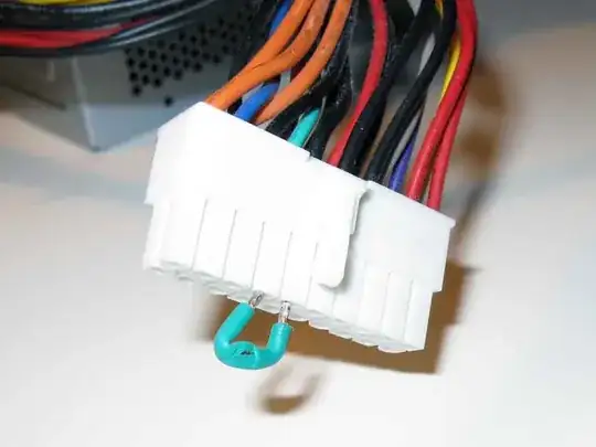

Unplug the power supply from any of the components inside the computer (or just remove it from the computer completely).
USE CAUTION HERE (Though you'd only be shocked with a max of 24 volts)
  1. Plug the power supply into the wall.
  2. Find the big 24-ish pin connector that connects to the motherboard.
  3. Connect the GREEN wire with the adjacent BLACK wire.
    (If you're colorblind, the green wire sits between three black wires on one end and one more on the other)
  4. The power supply's fan should start up. If it doesn't then it's dead.
  5. If the fan starts up, then it could be the motherboard that's dead. You can use a multimeter to check if there is power output from the power supply.

    +1, I've done this a few times. Looks like this http://www.tallahasseelights.com/tech/fm_transmitter/fm-004.jpg – hyperslug Aug 17 '09 at 17:58

    Fun fact: an ATX PSU is actually 2 psus in one case : the big one which can be turned on and off and a small 5V one that's always on and provides standby power. It is possible for only the standby part to fail, which will make the main PSU work when hotwired, but will still be useless in a PC, as without standby power the mobo could not turn the main part on. – Agent_L Jul 15 '16 at 14:18
  • @Agent_L Hence, step #5. Hot wiring is to check if the PSU is dead or if you have more checking to do. – Grant Jul 16 '16 at 23:37
  • @Grant My point is that the PSU can be working when hotwired, but still be dead for PC use. – Agent_L Jul 20 '16 at 09:09
  • @Agent_L We're saying the same thing. If hotwiring fails, the PSU is dead for sure. If it succeeds, move on to step #5 and keep checking. Nothing but a full test on every single wire can tell you if the power supply is good for sure (and even then, there might be an intermittently broken wire). Heck, you could cut off every wire except green and one black and hotwiring would still 'pass'. – Grant Jul 21 '16 at 16:27

To test the power supply unit, follow these instructions from Corsair in the Power Supplies FAQ:
My Machine doesn’t start up when I hit the power button, is the PSU faulty?
Disconnect everything from your PSU except for one single fan that should be connected directly to one of the Molex connectors. Then, get a small piece of wire, paper clip, or suitable object and short the green pin and a black pin on the 24-pin connector on the power supply. The voltage present is a very low signaling voltage so no worries of being shocked. Your PSUs fan should spin along with the fan you have connected to it. If this is the case, your PSU may not be receiving the power on signal from your motherboard and you should consider other causes of the problem you’re having.
When a computer is turned on, the motherboard electronically connects the green pin (power on signal) to any one of the black connectors (ground). This signals the PSU to start supplying power. By shorting these two connectors, you are testing the PSU to determine if it can turn on when signaled to do so. If this doesn't work, then the PSU has probably failed. More information what each pin does on an ATX power supply unit is available on Wikipedia.
