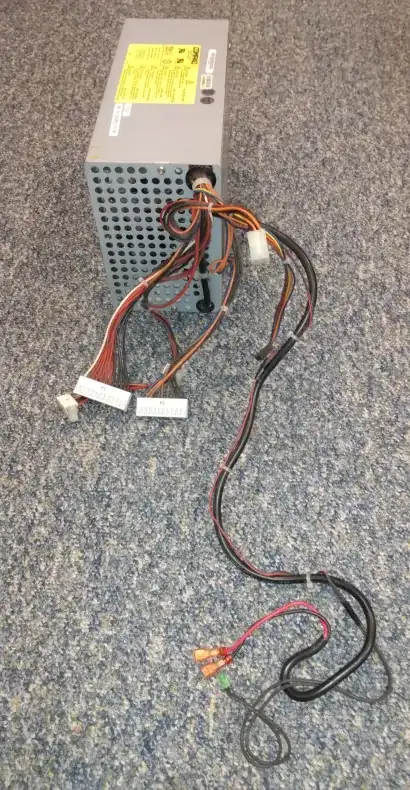

Generic answers are probably more useful for other people but, in case it helps, the details of this are:
It is for an Intel Pentium II server.
It is a 325W PSU.

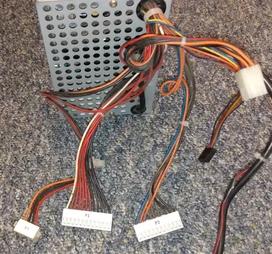

The connectors are mostly conventional but it is proprietary (Compaq Proliant 1600)
PSU PSU
The long lead goes to a front-panel "power on" LED and to a latching on/off switch. I can extract the switch and connect it to the end of the long lead for testing).
I have multimeters and can rustle up small test loads (fans, 10 W 10-20 Ω power resistors, etc)

  • Well, that PSU was connected to a motherboard, so you should be able to identify the on/off switch part (or, as you wrote, just connect that to the switch again). That should allow you to test voltages, unless your PSU requires an actual load to produce voltages (some rare custom PSUs do, though I am not sure if that ever applied to IBM PC PSUs). In that case, you need suitable resistors to simulate the load. Or in other words, that bridge for the ATX PSU that simulates the switch is at your "long end", if that is the question. – dirkt Jun 15 '21 at 19:48
    Many power supplies require a minimum load or they shut down. You might need to use some resistors or 12 volt and 6 volt (close enough) auto lamps as load. – DrMoishe Pippik Jun 15 '21 at 21:45
I believe this is an AT (not ATX) PSU with switching at the PSU. These (photo) are the leads for the power supply switch. You can connect them to a properly rated switch or jumper them but, if I remember correctly, this is a Double Pole Latching Switch for mains level voltage, so (this is not a joke) try to not kill yourself.
This differs from the newer ATX scheme which uses a low voltage momentary signaling which requests that the motherboard shutdown (press to power on/off; hold for 4 secs to force shutdown)
