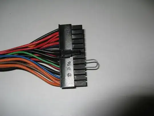

You can test whether the power supply has died by removing the 20(+4) pin connector from the motherboard, and shorting the GREEN wire pin to any BLACK wire pin.
Green To Black Shorting

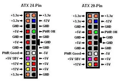

Connector PinOut Diagram
Upon doing this, the PSU should kick into action (any LED if present and fans should come on, as well as power rail outputs), and you would be able to measure 12v from a YELLOW to a BLACK wire, and 5v from a RED to a BLACK wire.
If the PSU doesn't react at all to this, the PSU is dead and will need replacing. If the PSU does react, you can try bridging the pins on your motherboard corresponding to the PWR_SW / POWER_SW. If that doesn't work, it's most likely the motherboard itself has a problem.

  • Out of curiosity, how do you short a green pin to a black pin? This seems like an excellent way to test a PSU as long as you have a multi meter laying around. And by kick into action do you mean the fans turn on? – DrZoo Feb 05 '16 at 19:13
  • @DrZoo Not sure if my terminology is perfect :) A paper clip between the two is how I usually connect them. And yes, LEDs (if present) and fans should come on, on the PSU. – Jonno Feb 05 '16 at 19:16
  • Ah I see! I wasn't sure if that's what that was in the picture or not lol. I'll have to keep this trick in my books! Hopefully I don't make sparks :) – DrZoo Feb 05 '16 at 19:25
