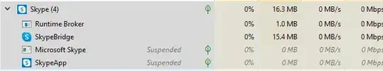

4) Skype
Even though Skype is Disabled during the start-up
Skype disabled during start-up
It still manages to run without personally executing it - and it is also part of the UWP group.
Skype UWP gorup
After ending the task it didn't start immediately, but during the waiting period of 20min, the process started to run:
Skype - Running again
Till eventually becoming the following: Skype - UWP as the beginning

As one could see from what I mentioned above, some apps are now running in the background without one open them up, and even if they are disabled during Start-up (check my question for answers on controlling start-up tasks).
Even though that is happening, one is able to close most of the tasks belonging to the UWP process group. However, one is not able to end Cortana nor Skype.
How does one fully disable UWP process group tasks from running automatically, more specifically Cortana and Skype, even after one closes them?
