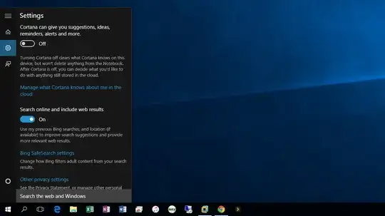

Disable it in the search settings:
  1. Click the search icon/box in the bottom left
  2. click the gear on the left bar
  3. Click off next to Cortana/Web Searches

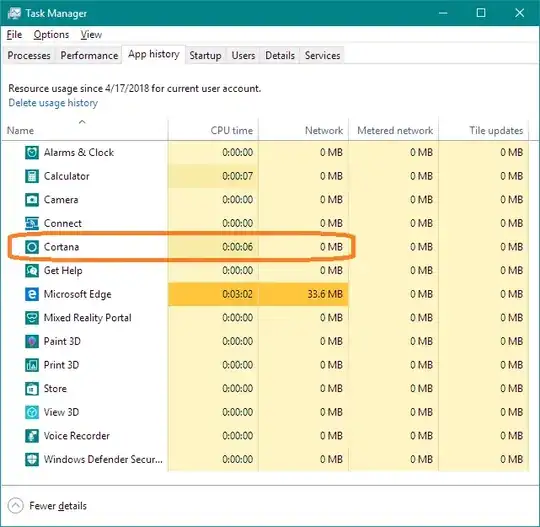

Open Task Manager and have it show More details. Right click on Cortana and select Open file location.
Task Manager

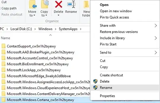

Now find the Cortana folder, right click it, and select Rename. I would recommend just adding ".bak" to the end of the folder name so you can find it easily if you want to restore it back to it's original status.
Rename

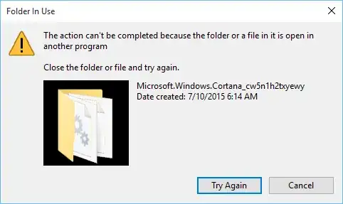

If you attempt to rename, it will tell you that the folder is in use.
Folder In Use
This is when you want to go back to Task Manager, right click on Cortana, and select End task.
End task
Right after the task ends, switch back to the Folder In Use window and click Try Again. The folder should be renamed and the Cortana task will not start again.

  • I could not rename the folder because windows kept rebooting the cortana process every time I stopped it. Solution? Boot using linux mint (primary os) and rename the folder. Take that microsoft and your futile attempts to sway me! – Marcel Oct 02 '15 at 18:41
  • Note: WernerCD's method just failed to work for me. PowerShell gave an error that Cortana can not be uninstalled because it is part of the operating system. The method in this answer did work for me. Thanks! – Todd Wilcox Jan 14 '16 at 16:03
  • @ToddWilcox Did you run an elevated PowerShell (Run as administrator)? – MC10 Jan 14 '16 at 21:22
    @MC10 Yes, I modified the properties of my PowerShell shortcut (among others) to always prompt for elevation. – Todd Wilcox Jan 14 '16 at 21:33

The easiest way to disable certain privacy aspects of Cortana is to use a third-party tool such as O&O Software's free ShutUp10.
Cortana in ShutUp10
Part of Cortana, though, is Windows Search, so there would still be an occasional Cortana process such as file indexing. However, there should no longer be any use of the internet by Cortana.
You can remove Cortana completely, if you wish, but that also removes Windows Search (though that might not be an issue if you use a third-party tool such as DocFetcher or Mythicsoft's Agent Ransack, which provide increased search functionality). That said, after a Windows 10 update, expect that Cortana would be reinstalled. Apparently, the only way now to permanently avoid Cortana is to use another OS, such as Linux.

Buried in the privacy policy for Win 10 (expand the Input Personalization section) is:
You can turn off Input Personalization at any time. This will stop the data collection for this feature and will delete associated data stored on your device, such as your local user dictionary and your input history. As Cortana uses this data to help understand your input, turning off Input Personalization will also disable Cortana on your device. At https://www.bing.com/account/personalization, you can also clear data sent to Microsoft, such as your contacts and calendar data, user dictionary, as well as search and browsing history if your device also had Cortana enabled.
According to HowToGeek, after installation, you can disable this by:
If you have chosen express settings and you want to opt out of some or all of these, all is not lost. You can still go into the settings and change things.
To turn off the first item found in the Personalization settings, you will need to open the Privacy group in Settings and then “Speech, inking, & typing”.
Click or tap “Stop getting to know me”.
I'd strongly recommend disabling it the officially supported way over screwing with an executable. The latter runs both the risk that Windows repair or a future Windows update to Cortana will install a new executable and re-enable it without your knowledge, or that because you removed the file the update will fail. With consumer versions of W10 not allowing you to opt out of patches, this could result in you getting stuck in a reboot loop due to the patch failing to install or lock you out of future security updates because you don't have one of last month's required patches.
