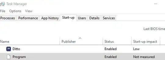

I am using a computer with Windows 10 and, as a normal procedure to reduce the boot time, I accessed the Task Manager and checked what was "Enabled" during the "Start-up".
Some of the programs
When I opened that tab, I saw a program called "Program", without Publisher information, which I have now disabled.
Program Disabled it
After that, I went straight to the Control Panel -> Programs and Features, in order to find out what the program is and to delete it; however, nothing with that name appears.
Given that, assuming that I don't know since when do I have that program on this computer, how can I know what this program is, so that I can decide on whether to remove it or not?

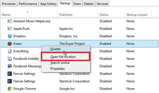

You can rightclick on an entry and click Open file location wich leads you to the directory where the program is installed.
Open file location

    This didn't work in this particular, as the "Open file location" was blocked (one couldn't press it). It just happened to me again. – Gonçalo Peres Jun 14 '20 at 18:26
  • @GonçaloPeres龚燿禄 Yes it can be. Go with Johns answer then. – kevinSpaceyIsKeyserSöze Jun 14 '20 at 19:05
