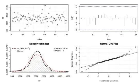

I use heavy tail Lambert W x F distributions to describe and transform leptokurtic data. See (my) following posts for more details and references:
Here is a reproducible example using the LambertW R package.

The qqplot of yy is very close to your qqplot in the original post and the data is indeed slightly leptokurtic with a kurtosis of 5. Hence your data can be well described by a Lambert W $\times$ Gaussian distribution with input $X \sim N (2000, 400)$ and a tail parameter of $\delta = 0.2$ (which implies that only moments up to order $\leq 5$ exist).
Now back to your question: how to make this leptokurtic data normal again? Well, we can estimate the parameters of the distribution using MLE (or for methods of moments use IGMM()),

and then use the bijective inverse transformation (based on W_delta()) to backtransform the data to the input $X$, which -- by design -- should be very close to a normal.

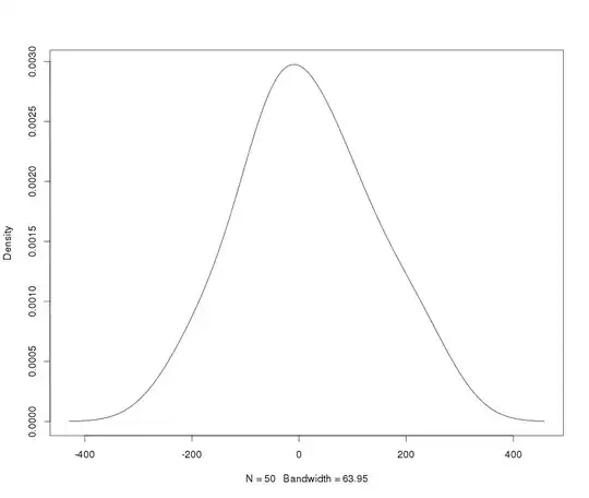

Credit for this answer goes to @NickCox's suggestion in the comments section of the original question. He suggested I subtract the median of the data and apply the transformation to the deviations. For instance, $\text{sign(.)}\cdot\text{abs(.)}^{\frac 1 3}$, with $Y-\text{median}(Y)$ as the argument.
Although the cube root transformation didn't work out well, it turns out the square root and the more obscure three-quarters root work well.
Here was the original kernel density plot corresponding to the Q-Q plot of the leptokurtic variable in the original question:
After applying the square root transformation to the deviations, the Q-Q plot looks like this:
Better, but it can be closer.
Hammering some more, applying the three-quarters root transformation to the deviations gives:
And the final kernel density of this transformed variable looks like this:
Looks close to me.
