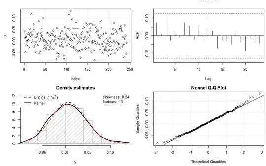

Then, I use the LambertW R package to transform the data so that it is closer to a normal distribution (as per this post):
mod.Lh <- MLE_LambertW(x, distname = "normal", type = "h")
summary(mod.Lh)
Call: MLE_LambertW(y = NAPChange, distname = "normal", type = "h")
Estimation method: MLE
Input distribution: normal
 Parameter estimates:
       Estimate  Std. Error  t value  Pr(>|t|)
mu    0.0057600   0.0028504   2.0208    0.0433 *
sigma 0.0383100   0.0031284  12.2459 < 2.2e-16 ***
delta 0.3429300   0.0677444   5.0621 4.146e-07 ***
Signif. codes:  0 ‘***’ 0.001 ‘**’ 0.01 ‘*’ 0.05 ‘.’ 0.1 ‘ ’ 1
Given these input parameter estimates the moments of the output random
variable are
  (assuming Gaussian input):
 mu_y = 0.01; sigma_y = 0.09; skewness = NA; kurtosis = Inf.
y <- get_input(mod.Lh)
test_norm(y)
$shapiro.wilk
Shapiro-Wilk normality test
data:  data.test
W = 0.99463, p-value = 0.5504
Now that the data is roughly normal, I can finally perform a t-test.
HOWEVER, how can I interpret/quantify the results after such a transformation? Is there a way to revert the results to their original form (i.e. untransform results)?
