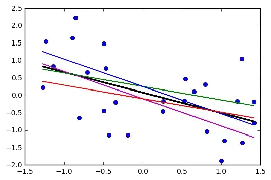

The accepted answer brings indeed the necessary intuition. It only misses the visualization of combining both linear and angular uncertainties, which refers very nicely back to the plots in the question. So here it goes. Let's call a' and b' the uncertainties of a, and b, respectively, quantities commonly returned by any popular statistics package. Then we have, apart from the best fit a*x + b, four possible lines to draw (in this case of 1 covariate x):
  • (a+a')*x + b+b'
  • (a-a')*x + b-b'
  • (a+a')*x + b-b'
  • (a-a')*x + b+b'
These are the four collored lines in the graph below. The black thick line in the middle represents the best fit without uncertainties. So to draw the "hyperbolic" shadings, one should take the maximum and minimum values of these four lines combined, which are in fact four line segments, no curves there (I wonder how exactely these fency plots draw the curving, doesn't seem any accurate to me).
I hope this adds something to the already nice answer from @Glen_b.
