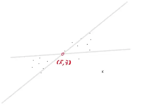

As you get farther from $\bar x,\bar y$ uncertainty increases. There's fewer and fewer observations when you reach out to distant regions of the domain of your function.
The main source of uncertainty is the one about the slope of the line. Take a look at the drawing here. With the given sample of observations you can say that the best fit line should be somewhere between these two grey lines. The uncertainty around $(\bar x,\bar y)$ is the smallest, but once you step away from where the observations are located, uncertainty increases.
Here's how we can intuitively "derive" the asymptotic confidence interval, i.e. where $x^*$ is very far away from your observations. The confidence given by model MSE will proportionally expand as $|x^*-\bar x|\to\infty$. Think of it as approximate equality of ratios $\frac{MSE}{\sqrt n\sigma_x}\approx \frac{CI(x^*)}{|x^*-\bar x|}$. That's the asymptotic of your formula: $$\lim_{x^*\to\infty} MSE \sqrt{\frac{1}{n} + \frac{(x^*-\bar x)^2}{\sum_{i=1}^n (x_i-\bar x)^2}} =\frac{MSE}{\sqrt n\sigma_x}|x^*-\bar x|$$

  • this is not true for linear regression which has a domain everywhere. Dave's answer is the correct one in this situation – rep_ho Nov 08 '21 at 10:05
  • maybe you have data between [0.1] and [100,101], but you will still see uncertainty around 50, far from the data, to be small and uncertainty where you have data large – rep_ho Nov 08 '21 at 10:51
  • @Aksakal, the point of rep_ho is that the reason "there's fewer observations" is not very clear, because the point $\bar{x}$ does not need to be the point with the most observations. You explain it in the comments, but in the answer it is unclear. – Sextus Empiricus Nov 08 '21 at 12:24
