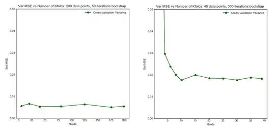

Simulations from a toy example showing decreasing / constant variance
Consider the following toy example where we are fitting a degree 4 polynomial to a noisy sine curve. We expect this model to fare poorly for small datasets due to overfitting, as shown by the learning curve.
Note that we plot 1 - MSE here to reproduce the illustration from ESLII page 243
 Methodology
You can find the code for this simulation here. The approach was the following:
  1. Generate 10,000 points from the distribution $sin(x) + \epsilon$ where the true variance of $\epsilon$ is known
  2. Iterate $i$ times (e.g. 100 or 200 times). At each iteration, change the dataset by resampling $N$ points from the original distribution
  3. For each data set $i$:
    • Perform K-fold cross validation for one value of $K$
    • Store the average Mean Square Error (MSE) across the K-folds
  4. Once the loop over $i$ is complete, calculate the mean and standard deviation of the MSE across the $i$ datasets for the same value of $K$
  5. Repeat the above steps for all $K$ in range $\{ 5,...,N\}$ all the way to Leave One Out CV (LOOCV)
Impact of $K$ on the Bias and Variance of the MSE across $i$ datasets.
Left Hand Side: Kfolds for 200 data points, Right Hand Side: Kfolds for 40 data points
Standard Deviation of MSE (across data sets i) vs Kfolds
From this simulation, it seems that:
  • For small number $N = 40$ of datapoints, increasing $K$ until $K=10$ or so significantly improves both the bias and the variance. For larger $K$ there is no effect on either bias or variance.
  • The intuition is that for too small effective training size, the polynomial model is very unstable, especially for $K \leq 5$
  • For larger $N = 200$ - increasing $K$ has no particular impact on both the bias and variance.

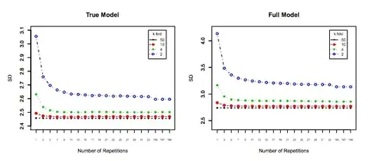

Experimental results Similarly, Zhang's experiments point in the direction of decreasing variance with K, as shown below for the True model and the wrong model for Figure 3 and Figure 5.
The only experiment for which variance increases with $K$ is for the Lasso and SCAD models. This is explained as follows on page 31:
However, if model selection is involved, the performance of LOO worsens in variability as the model selection uncertainty gets higher due to large model space, small penalty coefficients and/or the use of data-driven penalty coefficients

    Please note that simulations provided in the new answer by Xavier and also in this older Q by Jake Westfall, both demonstrate that the variance decreases with $K$. This directly contradicts your answer. So far I haven't seen any simulation that would support the claim that the variance increases with $K$ and is highest for LOOCV. – amoeba Jul 18 '18 at 11:43
    They demonstrate the variance decreases as $k \to N$ up to a certain point, where it remains flat. It is theoretically shown that the mean of correlated samples has more variance, therefore showing the result theoretically. That being said, you are right, an actual experiment which shows this is missing. I will do my best to construct it. – D1X Jul 18 '18 at 12:03
  • Yes the decrease with $K$ from $K=10$ to $K=N$ was due to an error in Xavier's answer. Now it's fixed and the variance indeed stays the same in this range. Given that two independent simulations show the same effect, I continue to be skeptical that LOOCV can be expected to have higher variance. Your theoretical argument is very hand-waving. The mean of correlated samples has higher variance only when everything else is the same. It's not clear that everything else is the same for 10-fold vs N-fold CV. Looking forward to your simulation. – amoeba Jul 18 '18 at 13:57

The issues are indeed subtle. But it is definitely not true that LOOCV has larger variance in general. A recent paper discusses some key aspects and addresses several seemingly widespread misconceptions on cross-validation.
Yongli Zhang and Yuhong Yang (2015). Cross-validation for selecting a model selection procedure. Journal of Econometrics, vol. 187, 95-112.
The following misconceptions are frequently seen in the literature, even up to now:
"Leave-one-out (LOO) CV has smaller bias but larger variance than leave- more-out CV"
This view is quite popular. For instance, Kohavi (1995, Section 1) states: "For example, leave-one-out is almost unbiased, but it has high variance, leading to unreliable estimates". The statement, however, is not generally true.
In more detail:
In the literature, even including recent publications, there are overly taken recommendations. The general suggestion of Kohavi (1995) to use 10-fold CV has been widely accepted. For instance, Krstajic et al (2014, page 11) state: “Kohavi [6] and Hastie et al [4] empirically show that V-fold cross-validation compared to leave-one-out cross-validation has lower variance”. They consequently take the recommendation of 10-fold CV (with repetition) for all their numerical investigations. In our view, such a practice may be misleading. First, there should not be any general recommendation that does not take into account of the goal of the use of CV. In particular, examination of bias and variance of CV accuracy estimation of a candidate model/modeling procedure can be a very different matter from optimal model selection (with either of the two goals of model selection stated earlier). Second, even limited to the accuracy estimation context, the statement is not generally correct. For models/modeling procedures with low instability, LOO often has the smallest variability. We have also demonstrated that for highly unstable procedures (e.g., LASSO with pn much larger than n), the 10-fold or 5-fold CVs, while reducing variability, can have significantly larger MSE than LOO due to even worse bias increase.
Overall, from Figures 3-4, LOO and repeated 50- and 20-fold CVs are the best here, 10-fold is significantly worse, and k ≤ 5 is clearly poor. For predictive performance estimation, we tend to believe that LOO is typically the best or among the best for a fixed model or a very stable modeling procedure (such as BIC in our context) in both bias and variance, or quite close to the best in MSE for a more unstable procedure (such as AIC or even LASSO with p ≫ n). While 10-fold CV (with repetitions) certainly can be the best sometimes, but more frequently, it is in an awkward position: it is riskier than LOO (due to the bias problem) for prediction error estimation and it is usually worse than delete-n/2 CV for identifying the best candidate.

    Is it possible to expand on this answer a little, perhaps to summarise some of the key aspects raised in the paper? – Silverfish Dec 16 '16 at 23:06
    Very interesting paper. In reviewing Kohavi (1995) I felt that many statements were impossibly broad and largely unsubstantiated. It is a folk-wisdom paper whose critical interrogation is long overdue. – Paul Jul 16 '18 at 16:31
  • If I understand Zhang & Yang correctly, they recommend "delete-n/2", which seems to be the mean of all ${n \choose 2}=n(n-1)/2$ possibilities to partition the traing set in two parts. This is something different than Leave-One-Out. – cdalitz Nov 23 '22 at 14:39

I think the standard error that we are talking about here is the standard error of the $MSE$s or $Err$s generated across different cross-validation iterations. But the simulation done by Xavier Bourret Sicotte calculated the standard error of $MSE$ or $Err$ based on repeatedly drawing different sample data from the population.
If you refer to the lecture on Cross-Validation of Rob and Trevor Hastie (free online), they gave the formula for standard error of $CV_k$ as
$$ \widehat{\mathrm{SE}}\left(\mathrm{CV}_{K}\right)=\sqrt{\sum_{k=1}^{K}\left(\operatorname{Err}_{k}-\overline{\operatorname{Err}_{k}}\right)^{2} /(K-1)} $$ where $$ \mathrm{CV}_{K}=\sum_{k=1}^{K} \frac{n_{k}}{n} \operatorname{Err}_{k} $$ where $\operatorname{Err}_{k}=\sum_{i \in C_{k}} I\left(y_{i} \neq \hat{y}_{i}\right) / n_{k}$
So in my opinion the simulation was not correctly done:
Generate 10,000 points from the distribution sin(x)+ϵ where the true variance of ϵ is known
Iterate i times (e.g. 100 or 200 times). At each iteration, change the dataset by resampling N points from the original distribution
For each data set i:
Perform K-fold cross validation for one value of K
Once the loop over i is complete, calculate the mean and standard deviation of the MSE across the i datasets for the same value of K <<this is where I think it is not right>>
Repeat the above steps for all K in range {5,...,N} all the way to Leave One Out CV (LOOCV)

  • I think you misunderstood what MSE stands for in that answer. The MSE is indeed the one in your answer, but it's averaged across multiple test runs. – syockit Sep 21 '21 at 14:23
  • Not sure what you are talking about. – Hai Vu Sep 28 '21 at 06:52
    The multiple test runs here, in the context of k-fold, is the k number of test runs. Is it not? What do you mean by saying "you misunderstood what MSE stands for"? – Hai Vu Sep 28 '21 at 06:53
