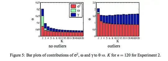

Example taken from the Yves Grandvalet and Yoshua Bengio (2004) paper
On the left an experiment with no outliers, variance falls with $K$, on the right an experiment with outliers, variance increases with $K$
