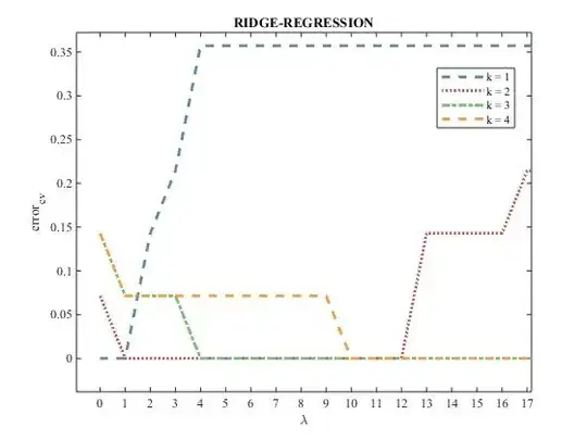

Model adjustments made: Following the comments by EdM and by Reading up on "An introduction to statistical learning". I realized that I need to incorperate some sort of feature shrinkage/selection, as I am working with a high-dimensionality problem. This was done by applying ridge-regression in combination with the Leave-One-Out Cross-Validation method (feature standardization was also applied). The graph below indicates thus the error on the cross validation set for different k-order polynomial decision boundaries and different values for the tuning parameter. The higher order-polynomials are given as an informative feature, as I don't really want to use these because it would only enlarge my high-dimensionality problem (as also indicated by EdM above).
note: I am not trying to convince a skeptical reader with my model. The goal is more to provide a proof-of-concept of application of Machine Learning in my research field.
Question: Ridge aregression still indicates that with a tuning parameter (lambda) of zero and a first degree factorization (k), the lowest error on the CV set is obtaind. This would thus effectively reduce the problem again to a least squares fit. Which, as I understood from the literature, cannot be used due to the high dimensionality. Am I missing something here or should I just do what the graph indicates and stick with the least squares fit?

Note that with 14 cases and 6 features it is possible to include all predictors in an unpenalized linear model. The theoretical impossibility of an unpenalized linear model arises when the number of features exceeds the number of cases. So your model including all features is not violating a strict "high dimensionality" cutoff, although the unpenalized model will probably be overfit.
Also, there are 3 potential problems in the way you are performing cross validation.
First, leave-one-out cross validation is not always a good choice, as discussed in detail on this page.
Second you seem to be using classification error as the measure of model quality. If so, that is probably not wise as misclassification error depends on your particular choice of a cutoff for the probabilities returned by your logistic regression model. A proper scoring rule like the Brier score is probably a better choice. It's best to first optimize the probability predictions, then apply whatever cutoff makes sense for classification (if classification is necessary). Although the Brier score is the mean-square error between predicted probabilities from the logistic model and the actual (0,1) values, note that no logistic regression is a "least squares fit," as a logistic model has no closed-form solution and the fit is based on maximum likelihood.
Third, it's not clear whether you standardized your continuous features before the ridge regression analysis. As the ridge penalty is applied to the sum of squares of all coefficients, without standardization you get different results if a predictor based on length, say, is measured in miles versus millimeters. (Some software does this automatically for you, then transforms coefficients back to the original scales.)
When studies in your field involve such a low ratio of cases to predictors, then there is not much hope of doing substantially better than what you already have done. As you might expect, the more complex models tend to require more penalization and it's not really clear that any of them will outperform the standard unpenalized (and likely overfit) model even if you use a proper scoring rule like the Brier score.
You could, however, consider using your knowledge of the subject matter to design simulations of data sets (with appropriate choices of coefficients and error terms) to evaluate how machine learning techniques might be of value in larger-scale studies.
