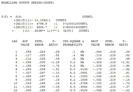

The final model suggests that there is a contemporary and lag1 effect of Count2 the user suggested causal series.enter image description here .The acf of the residuals suggest sufficiency enter image description here . The Transfer Function model expressed as a regression model (explicit) is here enter image description here

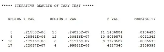

A significant change in the variance of the models errors was detected at period 14 suggesting that Weighted Least Squares was needed enter image description here and here enter image description here

EDITED AFTER CAUSALITY DIRECTION WAS CHANGED ... NOW COUNT2 IS A FUNCTION OF COUNT1
Here is the model ...enter image description here and the equation enter image description here.
There is a level shift at period 16 and a pulse at period 18 .
the lags of count1 that are useful to predict count2 are lags 2 and lags 5
The Actual and Fit graph is here enter image description here
