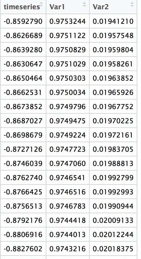

I have a time series data with two exogenous variables. I am using auto.arima from the forecast package to determine best fit. I wanted to know if I am implementing the auto.arima function correctly since I believe I am getting good forecast results. The figure below shows the sample time series of having 200 data points and 200 instances of exogenous variables (Var1, Var2) Time series data with 2 exogenous variables

  • why don't you post your entire data set and I will try and help you . The solution you are using apparently doesn't identify any needed lags or leads in the predictors or deal professionally/correctly with the possibility of unusual values such as pulses,level shifts,seasonal; pulses or local time trends effecting model form/parameters. – IrishStat Nov 10 '17 at 13:41
The approach you are using assumes that the two input (supporting series the X's) have a purely contemporaneous effect. The general approach to forming a ARMAX MODEL (Transfer Function) enter image description here
is as follows.
  1. develop arima models for the predictors
  2. pre-whiten to identify the form of the TF Which test for lagged effect of one time series on another? 3) identify pulses,level shifts, seasonal pulses (the I's) and add to the model 4) identify any additional arima structure 5) identify any additional lag structures in X that may be needed.
examine residuals to identify any additional structure.
You might also peruse https://stats.stackexchange.com/search?q=user%3A3382+transfer+function for more hints of forming a useful model
