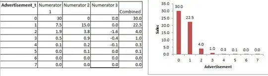

I used SAS to do most of my calculations(see this website). Now performing recursive calculation on the first part of equation as noted in the website translates to the following figure. What this tells you is that Advertisement at time $t = 0$ causes 30 incremental units in Sales all things being equal. This advertisement also has an effect in subsequent periods example at $t = 1$ the effect is 7.5 incremental units, and so on caused by denominator coefficient $\delta = 0.25$.
The second part and third part of the transfer function, by applying recursive calculation translates to following chart. For the second part notice that sales at $t=0$ equates to 15 unit of sales lag 2 and decays further. For third part of numerator causes sales to decline by -1.62 units at lag 3 and decays further.
Combining all the 3 parts of transfer function additively using basic algebra translates to the final form as shown below:
What this tells you is that advertisement at $t=0$ causes 30 units of sales at $t=0$ and 22.5 units of sales at $t=1$ and rapidly decreases to 4 units of sales at $t=2$ and so on ....
