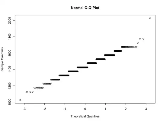

The qqplot looks like this.enter image description here These data appear normal if one outlier is removed at both ends (makes me think of this question) and if they are "jittered" uniformly over 50 cm3:enter image description here
If we ignore the outliers (I don't know what to do of them), this looks fine. Unfortunately, the p-value produced by the Shapiro-Wilk normality test appears to depend a lot on the jittering (i.e., I can't reproduce the p-value). Running the jittering one million times, the p-value is distributed like this:
I therefore cannot report a p-value when the data has been jittered.
What should I do? Is there a way of correcting for continuity before running a Shapiro-Wilk normality test?
