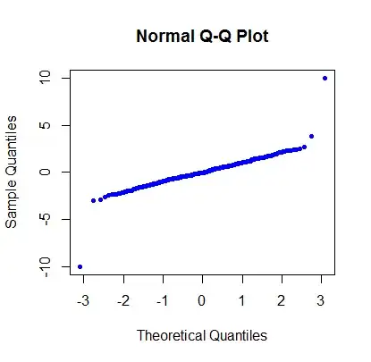

So I ran a quick "convincing-myself" test with R: To a $\small 500$ sample from a standard normal distribution, I added just a couple of asymptotic values $\small -10$ and $\small 10$. Just $\small 2$ data points: x <- c(rnorm(500),-10, 10). My thinking was that these two values couldn't possibly change our opinion - clearly the bulk of the data were normal by design. This was the obvious plot before introducing the -10, 10:
Two loose, possibly mistaken, values wouldn't make a dent. However, the plot was again "heavy-tailed" (not so unexpected now, given the observation on the $y$ axis construction):
... a ridiculously caricatured version of the first plot. My thought was that this could represent a well-known anomaly in some cases, warranting correcting. Surely statisticians must be in the habit of getting rid of these outliers... The most surprising part came when a Shapiro-Wilk test also seemed to comfortably rule out normality just because of these two values:

Are these essentially normal data no longer consistent with a normal distribution simply because of $2$ outliers? Can the new data be considered "heavy-tailed" because of these two dots sticking out at either end of the otherwise flat and straight QQ plot? And is this consistent with the mathematical definition of heavy tails?

The first plot looks to me quite similar to a mixture of a normal (most of the points) and something with larger variance and somewhat heavier tail (perhaps a 90-10 mixture but it's hard to judge) -- and possibly a slightly lower center. Of course, that doesn't mean the original process is physically a mixture of two original processes; you can get exactly the same appearance with something that has a distribution close to the distribution function of that mixture.
That wasn't remotely surprising to me, since they will dramatically affect the correlation in the plot, which directly impacts the closely-related Shapiro-Francia statistic (if my recollection is correct, you can regard it as a function of $R^2$ in the QQ-plot -- or possibly it is $R^2$, and it's also typically very close to the Shapiro-Wilk). So in fact I'd be surprised if two such large outliers didn't cause the Shapiro-Wilk to be significant given how big the sample is.
In fact I was playing with much larger samples just recently (yesterday? I think it was) with only a single outlier where the squared-correlation in the corresponding plot was really quite close to 0.

Are these essentially normal data no longer consistent with a normal distribution simply because of 2 outliers?
A contaminated distribution where a large fraction of the distribution (leading to 99.6% of the values in the sample) are from a standard normal and a very small fraction of the distribution (leading to 0.4% of the sample values) are from some distribution likely to produce values 10 sd's (10 of the uncontaminated distributions sd's) away from the mean is - clearly - not normal; we just said words to that effect.
You may well ask how much impact does it have on whatever thing you're interested in. For some things the impact may be great for other things it may be small, but normal populations have almost no chance of producing a sample like that.
A distribution that is likely to produce a sample like that would be called heavy tailed. We might also reasonably refer to the ecdf of that sample as 'heavy tailed'.
The plot clearly shows two extreme outliers, & that's reason enough to doubt that the data-generating process is well modelled by a normal distribution. Tests specifically designed for outlier detection may have more power to detect them than general-purpose normality tests, but that's not to say the latter won't or shouldn't.
I daresay you could find heavy-tailed, fat-tailed, long-tailed and/or leptokurtic distributions with which the data are consistent. See Example of heavy-tailed distribution that is not long-tailed.

The spacing between the last two extreme values of a tail of a distribution is robust and has been used to measure tail heaviness here. Edit: In other words, yes, two widely spaced adjacent extreme values in either tail are enough to yield a low probability of normality. However, a distribution can be non-normal, as the Q-Q plot below shows enter image description here The same data plotted on a Student's-t Q-Q plot looks a lot better enter image description here
So, we ask, what is an outlier? One property of outliers is that they tend not to be reducible on any Q-Q plot. For example, the extreme version of the Student's t distribution with one degree of freedom is also called the Cauchy distribution. The Cauchy distribution has "explained" outliers so severe that the mean value is undefined, but the median value is not. To get an average value from a Cauchy distribution one can indeed trim outliers and then calculate a stable "trimmed" mean value which value then better agrees with the median value.
What then is an outlier given that extreme values can be produced by a heavy-tailed distributions? Here is a partial answer. If extreme values are trimmed and the resulting distribution only after trimming is a normal distribution and if we have very good reason to expect a normal distribution from other evidence, then the trimmed values were indeed erratic outliers.
