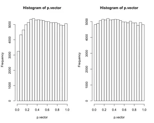

It turns out that with the unequal variance t-test almost all traits I have tested with the practice data are slightly to significantly more conservative than expected under normality. This is also the case with equal variance but the effect is much less pronounced. For the humerus (the long bone between the shoulder and elbow), after resampling and t-testing two groups, both of size 3, with unequal variance 100,000 times, 0.48% of p-values were under 0.01 and 7.52% were under 0.10. When I tested with equal variance, 0.95% of p-values were under 0.01 and 9.70% under 0.10. Histograms of p-values look like this, unequal variance on the left, equal variance on the right:

Why might it not be the case here? Is Welch more sensible to outliers or deviations from normality? Is Welch's Type I error rate not as close to nominal as the equal variance's error rate when sample sizes are very small?
EDIT: This seems to have something to do with the sample size. If instead of resampling 3 and 3 data points 100,000 times, I artificially do so for 12 and 12 data points, then for unequal variance 0.86% of p-values are under 0.01 and 9.78% are under 0.10, whereas for equal variance 0.92% of p-values are under 0.01 and 10.1% are under 0.10, with histograms that now look like this:
