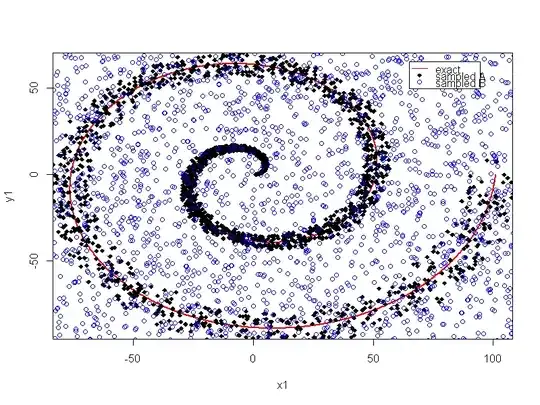

Toy Problem:
This is a trivial problem that is typically small in dimension and as accessible as possible to human intuition and learning. Personally, I find this (link, link) demo to be accessible for my intuition and learning. So do the folks at the Max Planck Institute for Biological Cybernetics.
The form of the "non-augmented" data is: $$ \begin{bmatrix} Class & X & Y\\ A& x_1 & y_1\\ A& x_2 & y_2\\ \vdots & \vdots & \vdots\\ B& x_n & y_n\\ \end{bmatrix}$$
The "physics" of the "good" class is a spiral starting at the origin while the bad class is uniformly random. The human eye can see that quickly. When evaluating "variable importance" we are trying to reduce the number of columns, but the non-augmented has no columns to reduce, thus we augment with random. There is the problem of overlap, it would be better to reclassify some of the uniform random within a range of "ideal" to class "A".
So here is the code that makes the "non-augmented" data:

#plot class "A" derivation
plot(x1,y1,pch=18,type="l",col="Red", lwd=2)
points(x2,y2,pch=18)
points(x3,y3,pch=1,col="Blue")
legend(x = 65,y=65,
       legend = c("true","sampled A","sampled B"),
       col = c("Red","Black","Blue"),
       lty = c(1,-1,-1),
       pch=c(-1,18,1))
Here is a plot of the non-augmented data. plot showing spiral of "A" and uniform random of "B"
