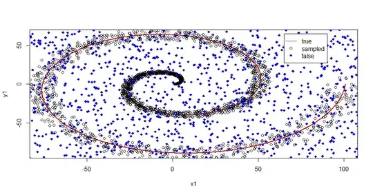

One of the strengths of a random forest is how well it applies to high-dimensional problems. I can't show 20k columns (aka a 20k dimensional space) in a clean visual way. It is not an easy task. However, if you have a 20k-dimensional problem, a random forest might be a good tool there when most others fall flat on their "faces".
This is an example of removing noise from signal using a random forest.
#housekeeping
rm(list=ls())
#library
library(randomForest)
#for reproducibility
set.seed(08012015)
#basic
n <- 1:2000
r <- 0.05*n +1
th <- n*(4*pi)/max(n)
#polar to cartesian
x1=r*cos(th)
y1=r*sin(th)
#add noise
x2 <- x1+0.1*r*runif(min = -1,max = 1,n=length(n))
y2 <- y1+0.1*r*runif(min = -1,max = 1,n=length(n))
#append salt and pepper
x3 <- runif(min = min(x2),max = max(x2),n=length(n)/2)
y3 <- runif(min = min(y2),max = max(y2),n=length(n)/2)
x4 <- c(x2,x3)
y4 <- c(y2,y3)
z4 <- as.vector(matrix(1,nrow=length(x4)))
#plot class "A" derivation
plot(x1,y1,pch=18,type="l",col="Red", lwd=2)
points(x2,y2)
points(x3,y3,pch=18,col="Blue")
legend(x = 65,y=65,legend = c("true","sampled","false"),
col = c("Red","Black","Blue"),lty = c(1,-1,-1),pch=c(-1,1,18))
Let me describe what is going on here. This image below shows training data for class "1". Class "2" is uniform random over the same domain and range. You can see that the "information" of "1" is mostly a spiral, but has been corrupted with material from "2". Having 33% of your data corrupt can be a problem for many fitting tools. Theil-Sen starts to degrade at about 29%. (link)
Now we separate out the information, only having an idea of what noise is.

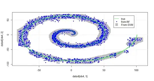

Compare vs. SVM
Here is the code to allow a comparison with SVM:
#now to fit to svm
fit.svm <-  svm(z~., data=data, kernel="radial",gamma=10,type = "C")
x5 <- seq(from=min(x2),to=max(x2),by=1)
y5 <- seq(from=min(y2),to=max(y2),by=1)
count <- 1
x6 <- numeric()
y6 <- numeric()
for (i in 1:length(x5)){
     for (j in 1:length(y5)){
          x6[count]<-x5[i]
          y6[count]<-y5[j]
          count <- count+1
data4 <- data.frame(x6,y6)
names(data4) <- c("x","y")
data4$z <- predict(fit.svm,newdata=data4)
idx4 <- which(data4$z==1,arr.ind=TRUE)
plot(data4[idx4,1],data4[idx4,2],col="Gray",pch=20)
points(data[idx1b,1],data[idx1b,2],col="Blue",pch=20)
lines(x1,y1,pch=18,col="Green", lwd=2)
grid()
legend(x = 65,y=65,
       legend = c("true","from RF","From SVM"),
       col = c("Green","Blue","Gray"),lty = c(1,-1,-1),pch=c(-1,20,15),pt.cex=c(1,1,2.25))
It results in the following image.
This is a decent SVM. The gray is the domain associated with class "1" by the SVM. The blue dots are the samples associated with class "1" by the RF. The RF based filter performs comparably to SVM without an explicitly imposed basis. It can be seen that the "tight data" near the center of the spiral is much more "tightly" resolved by the RF. There are also "islands" toward the "tail" where the RF finds association that the SVM does not.
I am entertained. Without having the background, I did one of the early things also done by a very good contributor in the field. The original author used "reference distribution" (link, link).
