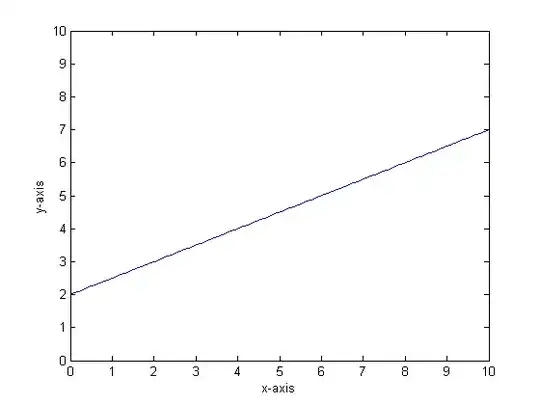

Let us say, for instance, that our function is y=0.5*x+2. A plot of that looks like the following: Figure 1
