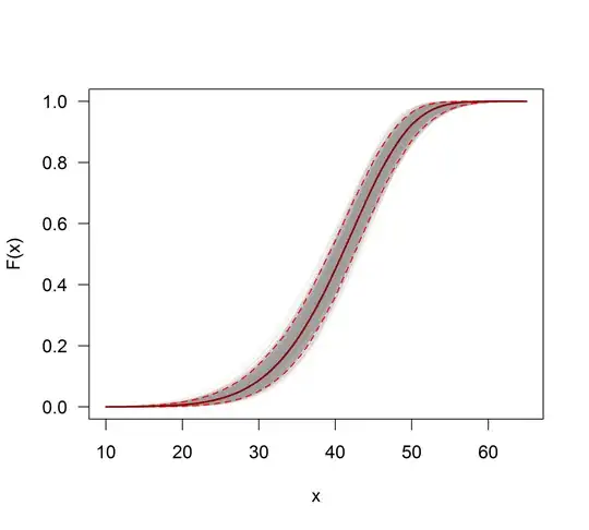

As explained here, we can use bootstrapping to add pointwise confidence intervals to the estimated Weibull PDF or CDF:
xs <- seq(10, 65, len=500)
true.weibull <- rweibull(1e6, shape= fit.weibull$estimate["shape"] , scale = fit.weibull$estimate["scale"])
boot.pdf <- sapply(1:1000, function(i) { xi <- sample(x, size=length(x), replace=TRUE) MLE.est <- suppressWarnings(fitdist(xi, distr="weibull"))
dweibull(xs, shape=MLE.est$estimate["shape"], scale = MLE.est$estimate["scale"]) } )
boot.cdf <- sapply(1:1000, function(i) { xi <- sample(x, size=length(x), replace=TRUE) MLE.est <- suppressWarnings(fitdist(xi, distr="weibull"))
pweibull(xs, shape= MLE.est$estimate["shape"], scale = MLE.est$estimate["scale"]) } )

# Plot CDF
par(bg="white", las=1, cex=1.2) plot(xs, boot.cdf[, 1], type="l", col=rgb(.6, .6, .6, .1), ylim=range(boot.cdf), xlab="x", ylab="F(x)") for(i in 2:ncol(boot.cdf)) lines(xs, boot.cdf[, i], col=rgb(.6, .6, .6, .1))
Add pointwise confidence bands
quants <- apply(boot.cdf, 1, quantile, c(0.025, 0.5, 0.975)) min.point <- apply(boot.cdf, 1, min, na.rm=TRUE) max.point <- apply(boot.cdf, 1, max, na.rm=TRUE) lines(xs, quants[1, ], col="red", lwd=1.5, lty=2) lines(xs, quants[3, ], col="red", lwd=1.5, lty=2) lines(xs, quants[2, ], col="darkred", lwd=2) #lines(xs, min.point, col="purple") #lines(xs, max.point, col="purple")
CI_CDF
