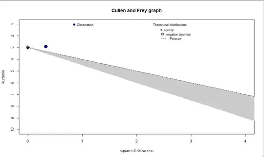

The first thing I did is to check my residuals:
library(fitdistrplus)
library(logspline)
descdist(x, discrete = TRUE)
summary statistics
min: -2.629229 max: 3.123659 median: -0.164249 mean: -0.000000000000000037898 estimated sd: 0.9253059 estimated skewness: 0.5777857 estimated kurtosis: 2.919639
fit <- fitdist(x, "norm")
plot(fit)
Returning to the question
If I am not violating any (CLM) assumptions, can I defend using OLS to estimate my model?
If I can defend this, would there still be anything to gain from using any other model (for example, a quasi poisson) and why then would that be?
