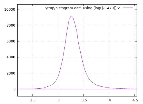

Since I was playing with Gnuplot, I then plotted a transform of log($1-479) which gave:-
log histogram
So I guess I've answered my own question. Still looks a bit skewy though. I guess it's now simply a matter of fitting a normal distribution to the transformed histogram...
