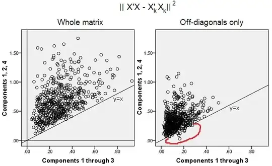

  • On tiny notion. The so called "Heywood case" (unreasonable communality $\psi$ value appears and breaks FA), although it may have various causes, it usually appears when you set $k$ higher than "optimal". Actually it might be a testimony for a statement that there exist optimal or "true" $k$ and hence your statement that $k$ is always subjective because we always explain correlations better and better as k grows is questioned. Heywood case might be that "natural plague" which baffles one's overfitting optimism in FA. If your above stance is vulnerable difference bw PCA and FA resuscitate. – ttnphns Nov 08 '14 at 02:16
  • And another one. FA does iterations and aims to fit correlations on each one. That means that correlation values in the matrix get fit relatively evenly in the end - it is the purpose of FA, whatever is $k$. We don't see such concern in PCA: as $k$ grows, correlations may get fitted better in uneven and unpredictable way. So, the "bigger k - better fit" dictum only disguises difference between FA and PCA. – ttnphns Nov 08 '14 at 02:38
    Also. Why the (non-hierarchical form of) dependency of factor solution on $k$ should be counter-intuitive and confusing?. Factors are not hierarchical by nature (I'm not speaking of the so called 2nd order factors here). It is unclear why I must expect the 1st factor to be the same in a 1-factor and 5-factor solutions. It is comfortable, for sure, but why should it be a law? – ttnphns Nov 08 '14 at 02:51

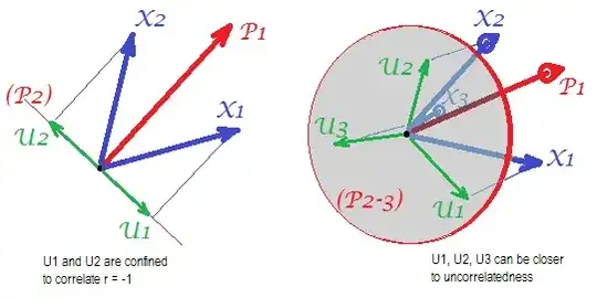

  • To unite with @gung and to cross the t's: Those formulas in your answer which you call "models", are not the models at all. They are called the component/factor theorems and are the consequences of the models. Factor/PCA models are described in the first paragraph here. – ttnphns Nov 08 '14 at 05:09
  • ... and, because you are not correct saying that FA and PCA only differ in how they treat the diagonal (for, on the contrary, they differ in how they care about the off-diagonal), you are wrong when you state that their results become similar as $n$ grows because the diagonal becomes relatively lighter and lighter. – ttnphns Nov 08 '14 at 06:58

  • Hi, amoeba, thank you a lot for the Update 3 demonstration. May I ask you - 1) why did you (strangely) make only 40 observations in X? This configuration is singular, which a problem for FA. Although some implementations can handle with it is generally considered as inappropriate for FA. 2) Also, what FA extraction method did you use? 3) Didn't you encounter Heywood case sometimes? – ttnphns Nov 17 '14 at 15:55
  • @ttnphns: (1) If I take a lot of observations to make $C$ non-singular, then it becomes pretty much diagonal with all correlations almost zero (all green on my figure). This makes diagonal really "stand out" of the rest and so makes PCA perform worse on the off-diagonal part (i.e. my "ratios" increase). Also, it is not a typical correlation matrix to run PCA or FA. Ideally, I would take a random $C$ which is positive-definite and has many strong correlations, but I don't know how to generate it. (2) Self-coded principal axis, iterated until convergence. (3) Not 100% sure, but I think not... – amoeba Nov 17 '14 at 17:46
  • @ttphns: I updated my Update 3 and used a properly generated random correlation matrix (so that it is full-rank and not singular). I am writing it here mainly to point out for possible future readers of these comments that your question (1) from above does not apply anymore. – amoeba Nov 25 '14 at 14:15
  • Dear amoeba I've just appended a comment concerning the problem of the estimation of the $\Psi$ but because of the length I made it another answer. Please see there – Gottfried Helms Dec 04 '14 at 15:03
