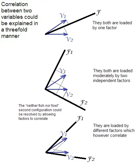

  1. Reason for rotation. Rotations are done for the sake of interpretation of the extracted factors in factor analysis (or components in PCA, if you venture to use PCA as a factor analytic technique). You are right when you describe your understanding. Rotation is done in the pursuit of some structure of the loading matrix, which may be called simple structure. It is when different factors tend to load different variables $^1$. [I believe it is more correct to say that "a factor loads a variable" than "a variable loads a factor", because it is the factor that is "in" or "behind" variables to make them correlate, but you may say as you like.] In a sense, typical simple structure is where "clusters" of correlated variables show up. You then interpret a factor as the meaning which lies on the intersection of the meaning of the variables which are loaded enough by the factor; thus, to receive different meaning, factors should load variables differentially. A rule of thumb is that a factor should load decently at least 3 variables.
  2. Consequences. Rotation does not change the position of variables relative to each other in the space of the factors, i.e. correlations between variables are being preserved. What are changed are the coordinates of the variable vectors' end-points onto the factor axes - the loadings (please search this site for "loading plot" and "biplot", for more)$^2$. After an orthogonal rotation of the loading matrix, factor variances get changed, but factors remain uncorrelated and variable communalities are preserved.
In an oblique rotation factors are allowed to lose their uncorrelatedness if that will produce a clearer "simple structure". However, interpretation of correlated factors is a more difficult art because you have to derive meaning from one factor so that it does not contaminate the meaning of another one that it correlates with. That implies that you have to interpret factors, let us say, in parallel, and not one by one. Oblique rotation leaves you with two matrices of loadings instead of one: pattern matrix $\bf P$ and structure matrix $\bf S$. ($\bf S=PC$, where $\bf C$ is the matrix of correlations between the factors; $\bf C=Q'Q$, where $\bf Q$ is the matrix of oblique rotation: $\bf S=AQ$, where $\bf A$ was the loading matrix prior any rotation.) The pattern matrix is the matrix of regressional weights by which factors predict variables, while the structure matrix is the correlations (or covariances) between factors and variables. Most of the time we interpret factors by pattern loadings because these coefficients represent the unique individual investment of the factor in a variable. Oblique rotation preserves variable communalities, but the communalities are no longer equal to the row sums of squares in $\bf P$ or in $\bf S$. Moreover, because factors correlate, their variances partly superimpose$^3$.

  1. Choice. There are many forms of orthogonal and oblique rotations. Why? First, because the concept of "simple structure" is not univocal and can be formulated somewhat differently. For example, varimax - the most popular orthogonal method - tries to maximize variance among the squared values of loadings of each factor; the sometimes used orthogonal method quartimax minimizes the number of factors needed to explain a variable, and often produces the so called "general factor". Second, different rotations aim at different side objectives apart from simple structure. I won't go into the details of these complex topics, but you might want to read about them for yourself.
Should one prefer orthogonal or oblique rotation? Well, orthogonal factors are easier to interpret and the whole factor model is statistically simpler (orthogonal predictors, of course). But there you impose orthogonality on the latent traits you want to discover; are you sure they should be uncorrelated in the field you study? What if they are not? Oblique rotation methods$^5$ (albeit each having their own inclinations) allow, but don't force, factors to correlate, and are thus less restrictive. If oblique rotation shows that factors are only weakly correlated, you may be confident that "in reality" it is so, and then you may turn to orthogonal rotation with good conscience. If factors, on the other hand, are very much correlated, it looks unnatural (for conceptually distinct latent traits, especially if you are developing an inventory in psychology or such, - recall that a factor is itself a univariate trait, not a batch of phenomena), and you might want to extract less factors, or alternatively to use the oblique results as the batch source to extract the so-called second-order factors.
