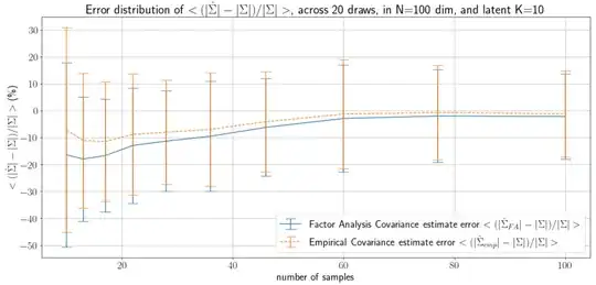

I do not see that Factor Analysis gives a better covariance estimate than the empirical covariance estimate, from the toy data simulation with explanation and code below. Am I doing something wrong?
Generative model setup
From the CS229 lecture notes on Factor Analysis, I built a (random) generative model for Factor Analysis with observation dimension $N$, latent dimension $K$ and number of samples $M$, and a ground truth mean of $\mu=0$:
$$x=Wz+\epsilon$$
with
$$W=\Lambda\sim U(0,1)^{N\times K}\in\mathbb{R}^{N\times K}\\ z\sim\mathcal{N}(0,I_K)\in\mathbb{R}^{K}\\ \epsilon \sim\mathcal{N}(0,\Psi)\in\mathbb{R}^{N}\\ \Psi=diag(\psi)\\ \psi\sim U(0,1)^{N}$$
From this we can construct a (derived) ground truth covariance matrix $\Sigma\in\mathbb{R}^{100\times100}$. I use an observation dimension of $N=100$ and latent dimension of $K=10$.
Sampling
I sample data from this generative model for a different number of total observed samples $m$, yielding a data matrix $X\in\mathbb{R}^{N\times M}$ and for every specific number of samples I average the covariance estimation error across 20 different seeds. I compare the covariance matrix recovered by Factor Analysis $\hat{\Sigma}_{FA}$ to the empirical covariance matrix $\hat{\Sigma}_{emp}$. This is done in terms of the difference with respect to the true covariance matrix under a Frobenius norm: $$||\Sigma - \hat{\Sigma}||_F$$
Results
Strangely enough, the Factor Analysis covariance estimate seems to not perform significantly better than the empirical covariance estimate, even though it does get the true latent dimension size ($K=10$) given:
To put the relative error (%) w.r.t. the true covariance in perspective (where |·| is taken elementwise):
Results with higher $N$, seem to show little (relative) change. Here for $N=1000, K=10$:
Question
I would expect the Factor Analysis covariance estimate to have a significantly lower error w.r.t. the true covariance than the empirical covariance estimate, especially in the small sample setting. Am I doing something wrong?

  • I don't do this sort of thing in python, so I'm not 100% sure, but I think you need to make N larger to see a difference. – Jeremy Miles Mar 03 '22 at 17:38
  • @JeremyMiles thanks for the suggestion! I added the result with 10x higher N, but there seems to be little change in the relative performance of FA and its empirical counterpart. Also, suggestions outside of Python are welcome to maybe solve the question differently? R? – Arnout Devos Mar 03 '22 at 22:38
  • I can't quite read the uncommented python code. Are you sure you are doing FA extraction and not PCA extraction? – ttnphns Mar 05 '22 at 19:45
  • Thanks for the comment @ttnphns! On top I import sklearn.decomposition. FactorAnalysis and then (1) initialize it as model_fa = FactorAnalysis(n_components=lat_dim) and (2) fit it on the data with model_fa.fit(X.T). Then I extract the covariance matrix with est_fa_cov = model_fa.get_covariance().The official documentation provides more info and examples: https://scikit-learn.org/stable/modules/generated/sklearn.decomposition.FactorAnalysis.html – Arnout Devos Mar 06 '22 at 20:53
  • Are you sure your est_fa_cov = model_fa.get_covariance returns you the full reproduced covariance matrix (i.e., with original variances on the diagonal) and not the reduced reproduced one (i.e., with communalities on the diagonal)? – ttnphns Mar 07 '22 at 01:23
  • @ttnphns I suppose so: the documentation states that get_covariance() returns components_.T * components_ + diag(noise_variance). This corresponds exactly to the reproduced covariance matrix as stated in the CS229 lecture notes on page 6. – Arnout Devos Mar 07 '22 at 13:11
I am assuming (without going to deal with python functions) that your post is in fact asking: Is covariance matrix $\bf\hat R$ reproduced by Factor analysis of a sample covariance matrix $\bf R$ a better (closer) estimate of the population ("true") covariance matrix $\bf R_t$ than $\bf R$ is? That is, is $\bf ||R_t-\hat R||$ smaller than $\bf ||R_t-R||$, where $\bf R$ is a random realization of $\bf R_t$ for some sample size $n$?

  • First, thanks a lot for the detailed explanation and simulation! Three remarks/questions: (1) could you share numerical results/graphs? (2) I don't see how replacing the diagonal is motivated in FA; loadings^T*loadings + psi should be equivalent, no? (it is not in simulation :( ) (3) I am still underwhelmed by FA's covariance estimate in my simulations: only sometimes a few % better than empirical (in Frobenius norm), and on average 10-20% away from the true cov in a small sample setting (note that some (co)variances are estimated up to 100% wrong). I would expect like 1% relative error. – Arnout Devos Mar 07 '22 at 17:47
  • (1) Sorry, I will not give pics; the primary reason is that pics would be expressive if I did this time simulations on different numbers of n, p and m, but I had done on them only 200, 50, an 5, respectively. (2) In FA, the diagonal of AA' is called communalities and their complements to the diagonal of the analyzed cov. matrix - the variances - are called uniquenesses. So if you are comparing some full cov. matrices, i.e. having variances on their diagonals, you must have variances there in them both (and not to have variances in one matrix and communalities in the other, as the diagonal). – ttnphns Mar 07 '22 at 18:15
  • I might recommend you to do exactly like and what I did, if you wish. Will you arrive at the same conclusions or not? – ttnphns Mar 07 '22 at 18:19
  • Will you arrive at the same conclusions or not?. Yes. But, "positive" or "negative" only give directions, not sizes or percentages; covariance matrix items which are 10-20% off on average (compared to the true covariance) are still quite unsatisfactory, despite FA doing consistently better than the empirical covariance. That is why I am interested in the % w.r.t. true covariance. With these results it seems that FA is useless for covariance estimation, with its consistent but marginal improvement over the empirical covariance estimate. – Arnout Devos Mar 07 '22 at 18:28
  • P.S. To (2) point. FA does not estimate variances; it estimates only co-variances. The variances - it splits them each into two summands: the communality part and the uniqueness part. The communality part is the direct function of the loadings, so can be said is "estimated", like loadings are, but the uniqueness is simply the counterpart left. The sum of the two summonds always equals the input variance. – ttnphns Mar 07 '22 at 18:29
  • The sum of the two summonds always equals the input variance. -> I agree, theoretically. But this does not seem to be the case in my simulation (comparing the numbers) --> there must be a bug in sklearn.decomposition.FactorAnalysis? – Arnout Devos Mar 07 '22 at 18:34
  • FA is useless for covariance estimation. The primary goal of FA is not estimation of population covariances via sample covariances. The primary goal is to try to uncover factors, to produce the loadings, and the loadings are used to intepret the meaning of the latent factors. – ttnphns Mar 07 '22 at 18:35
  • there must be a bug. Not much likely. Get the loadings A and compare AA' with the cov. matrix your FA function returns to you. Will it differ? How? Also, check attentively what your FA function actually is doing with your data and input parameters. What method of extraction is used. Are really covariances (and not correlations) analyzed? How many factors are extracted? Is there any rotation? Check all this. – ttnphns Mar 07 '22 at 18:47
  • @ttnphns: for sample covariance, did you use the unbiased or biased estimator? When I use the biased estimator 1/N or better 1/(N+1) rather than 1/(N-1), the results are not anymore so much in FA's favor. – Pontus Hultkrantz Sep 21 '23 at 10:09
  • @PontusHultkrantz, since I did not generate samples of data (observations), I did not estimate sample covariances R from the data. Rather I directly genereted R as a Wishart realization. Then R is, of course, unbiased. If I were computing (equivalently) R from a generated data sample, I would use the N-1 denominator to keep R unbiased. – ttnphns Sep 21 '23 at 11:40
  • @ttnphns: right, so you use the unbiased sample covariance estimator with 1/(N-1) scale. If you instead use 1/(N+1) which has lower Frob norm (lower MeanSqErr), the FA does no longer seem to be that much better of an estimate than sample cov. However, if the FA estimate is unbiased, it might not be fair to compare it with a biased estimator? – Pontus Hultkrantz Oct 06 '23 at 03:31
